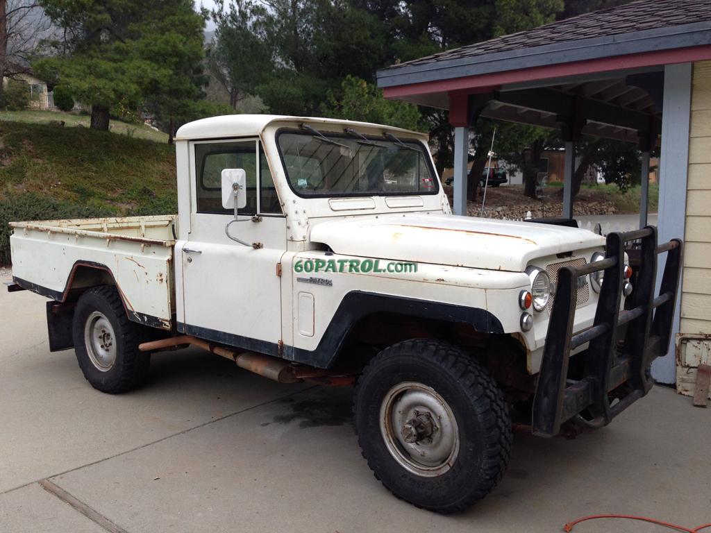

These wheels on Ducky were listed on Ebay as fitting a 2001 or so Tacoma or Tundra. They do have a positive offset. 30mm (about 1.2"). This is the difference between the centerline of the wheel and the mounting surface of the wheel itself. A positive offset will set the wheel further back in the opening, thus less likely to rub on fenders during suspension travel. Too much positive offset will create the problem RP described.
Here's a better explanation:
https://www.tacomaworld.com/threads/whe ... fo.102992/
Long story short, those wheels/tires should fit great. My only disclaimer is my cut rear fenders. I took some pictures, front, rear inside and outside to show the clearances I have. IMO I don't think you can fit any taller or wider tires under a stock patrol.
I hope these help. Lots of anxiety buying tires and wheels for an "unknown" application.
