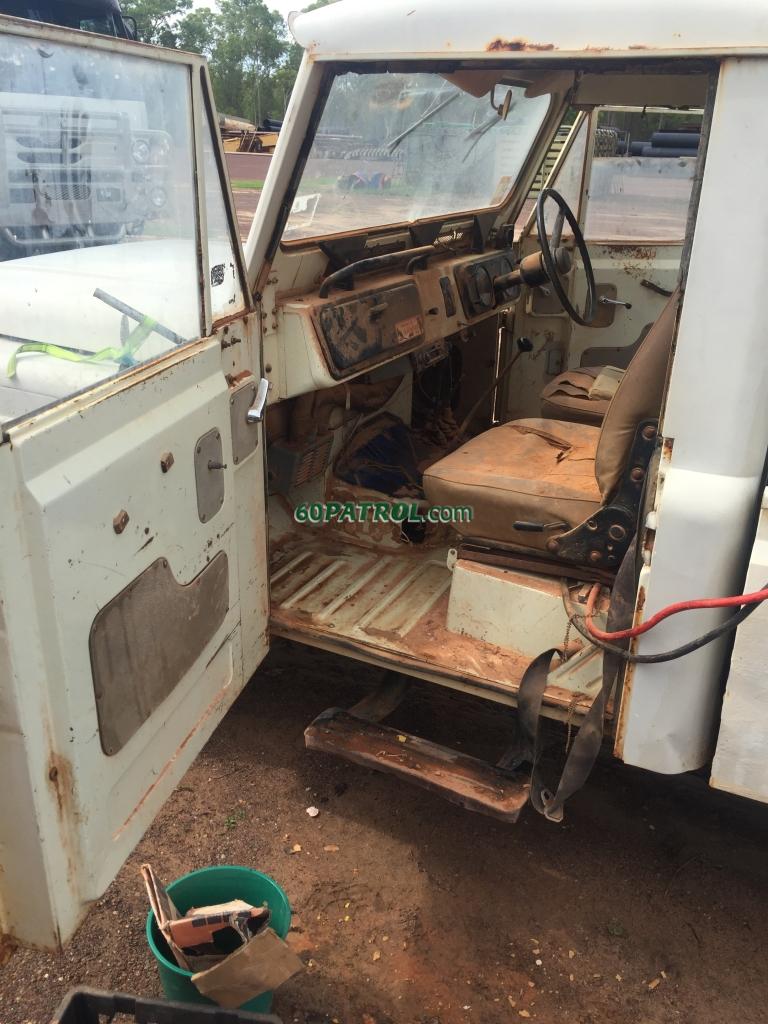

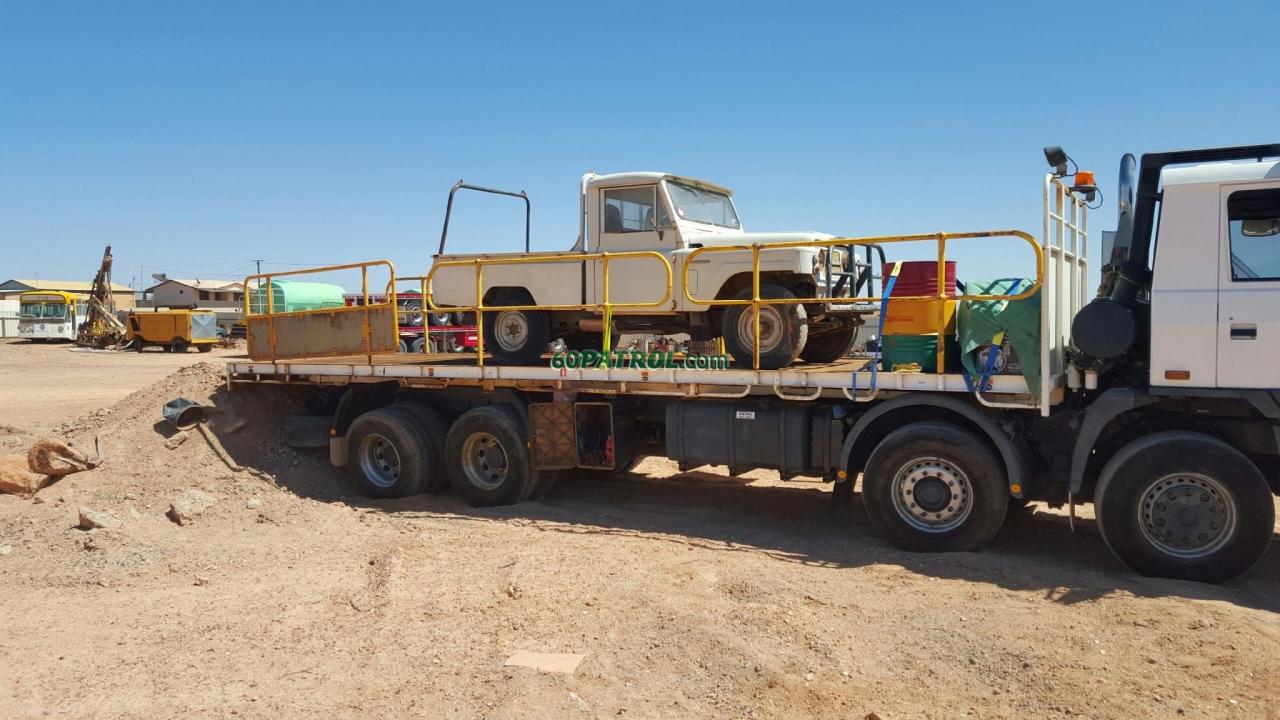

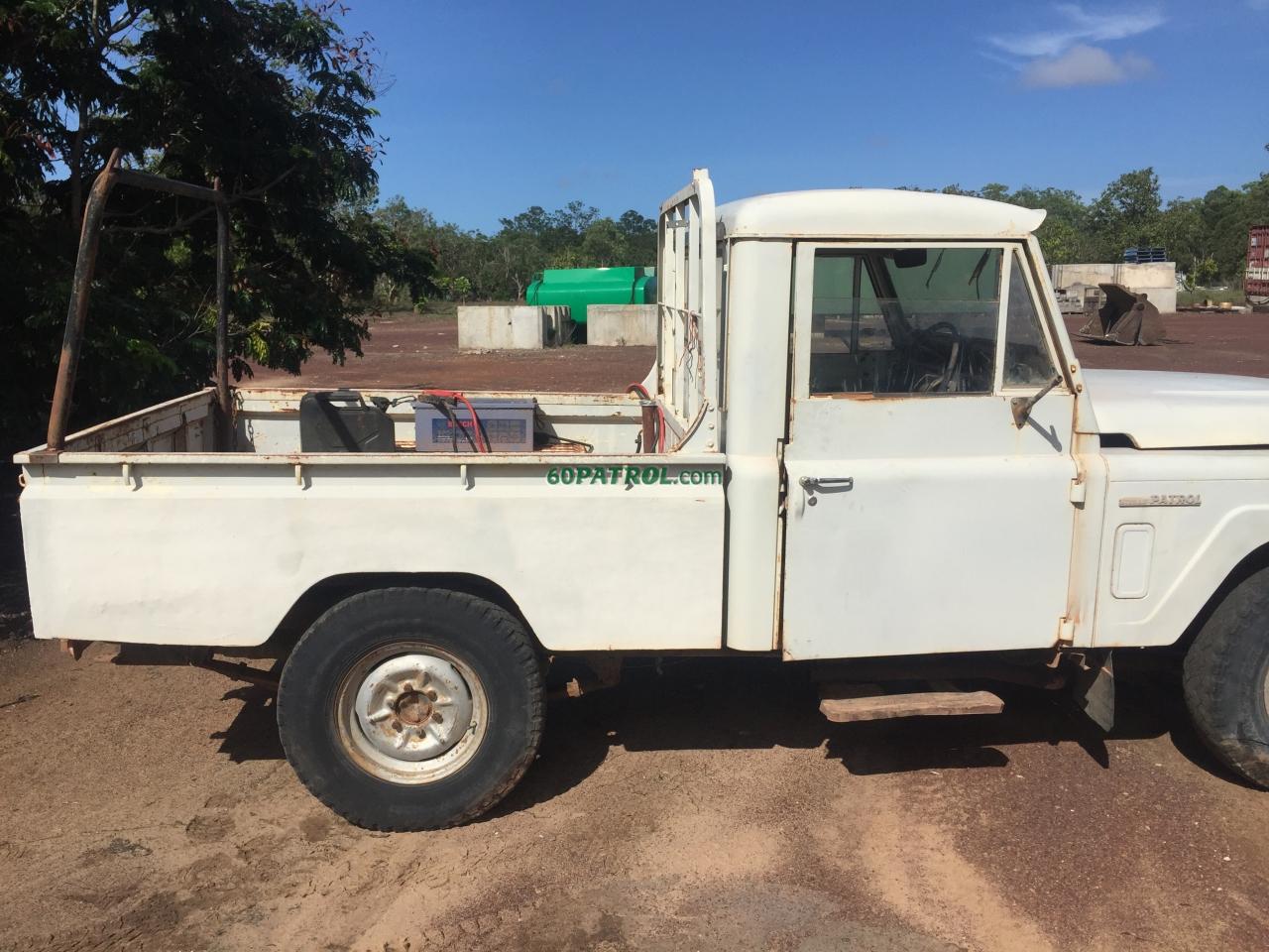

So in December 2015 I found my first G60 and first car project I was searching for a vehicle which was unique and could also be transformed into a nice and capable 4x4. When I came across my G60 I was hooked and bought it for $259 dollars

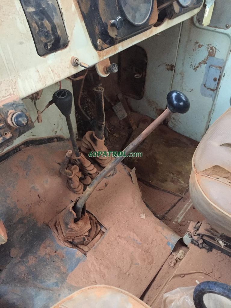

This is from when I first picked her up and had a drive
5135513447615102
After having a drive I began pulling all the rubbish and blowing the dirt and dust out before I could even begin dissembling her.

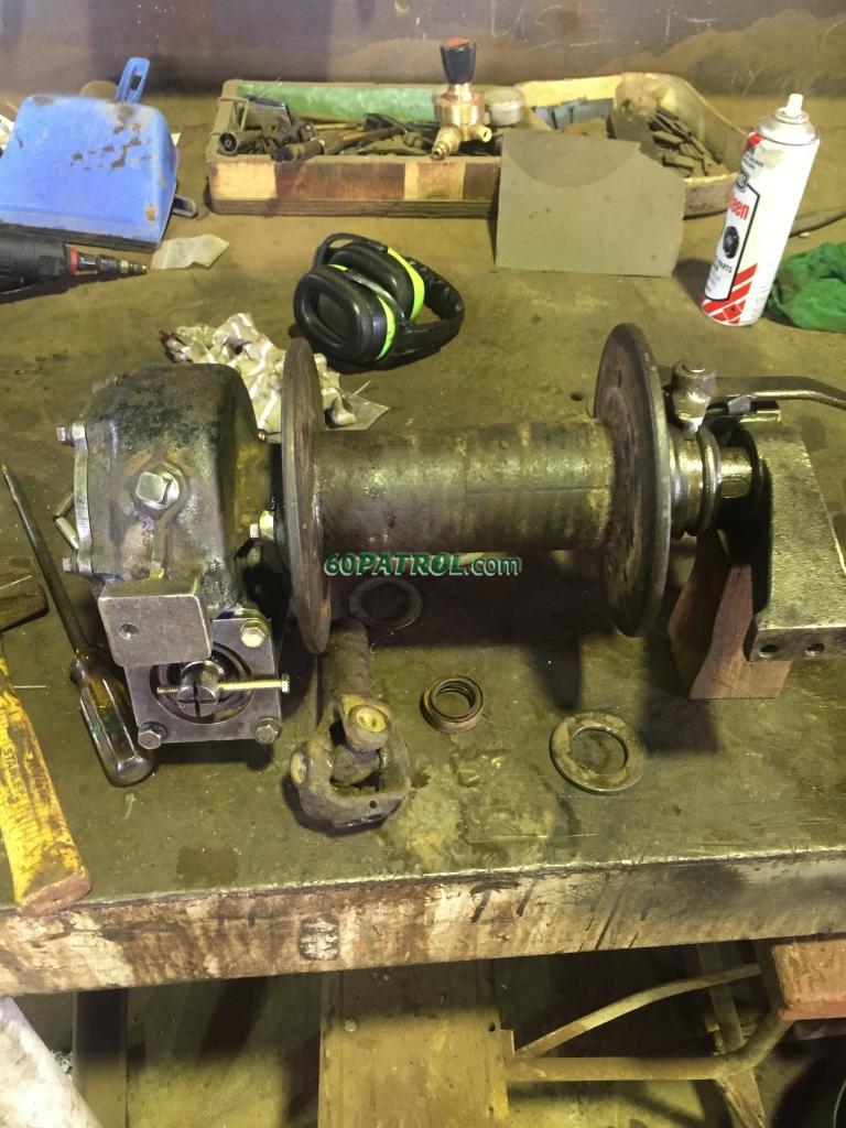

The winch it's self had broken mounts and required some love.
51405139

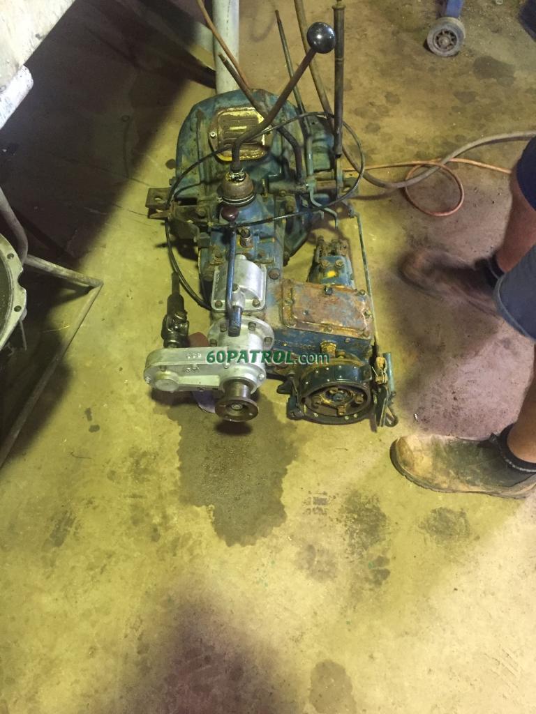

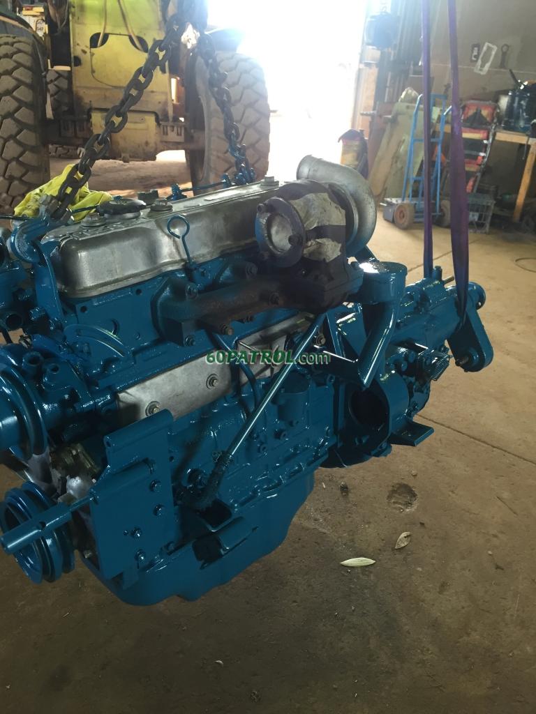

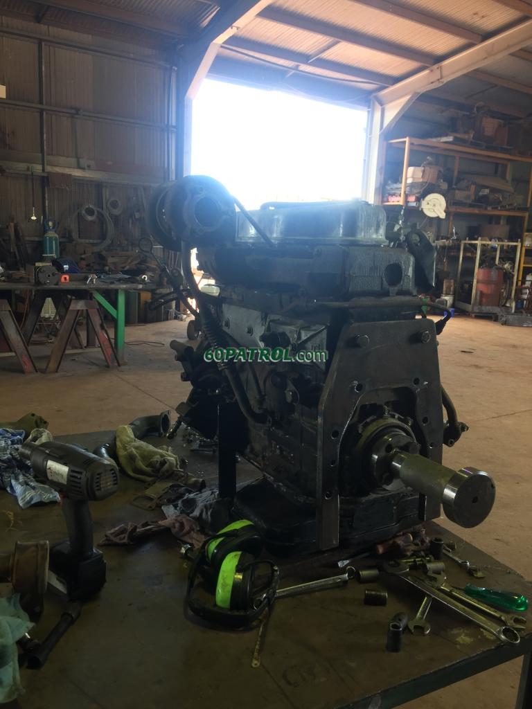

At my grandparents farm I picked up a old Isuzu 3.9L 4cylinder diesel. Although I took away the original p40 engine I was still attracted to that 3speed gearbox just for how unique it is, so this required me to build a rather simple adapter plate which I bolted to the engine and then bolted the gear box to it. Inside I used a combination the Isuzus fly wheel with the p40's clutch this adaption was really simple. After lining it all up we bolted it together we searched for a turbo and luckily enough knowing the right guy we got our hands on a old excavator which had the same Isuzu motor. So managed to pick a turbo,rather large sump a exhaust manifold and some other Nic nacs. After assembling all the new goodies I gave it all a fresh coat of paint to match the original bluey colour.
5142514351415144
Placing the engine onto the chassis only required moving the front mount back and a small adjustment inwards for it to all fit nicely, once he engine was in with the gear box we decided to put the cab back on seeing how it all fit. And it was just about perfect minus the turbo just touching the passengers foot well this required only minor modifications to allow it to fit. While the cab was on I went hunting for some seats to replace the old ones. From a wreckers I found some very nice leather seats for $80, for the two.

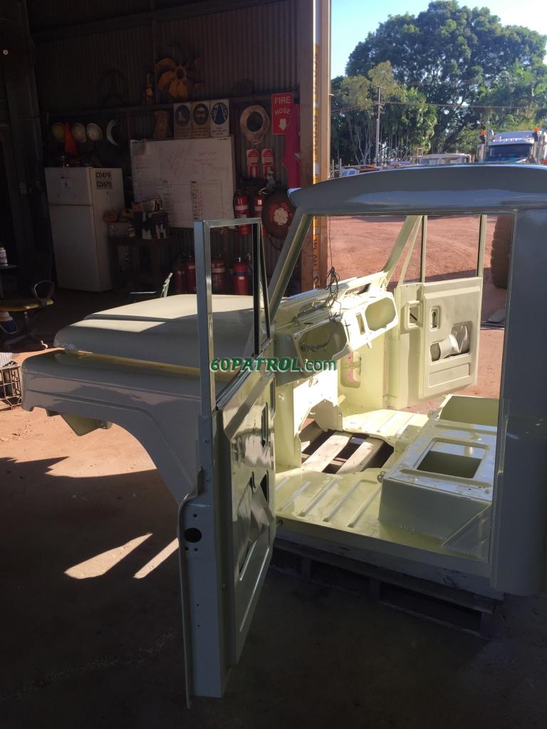

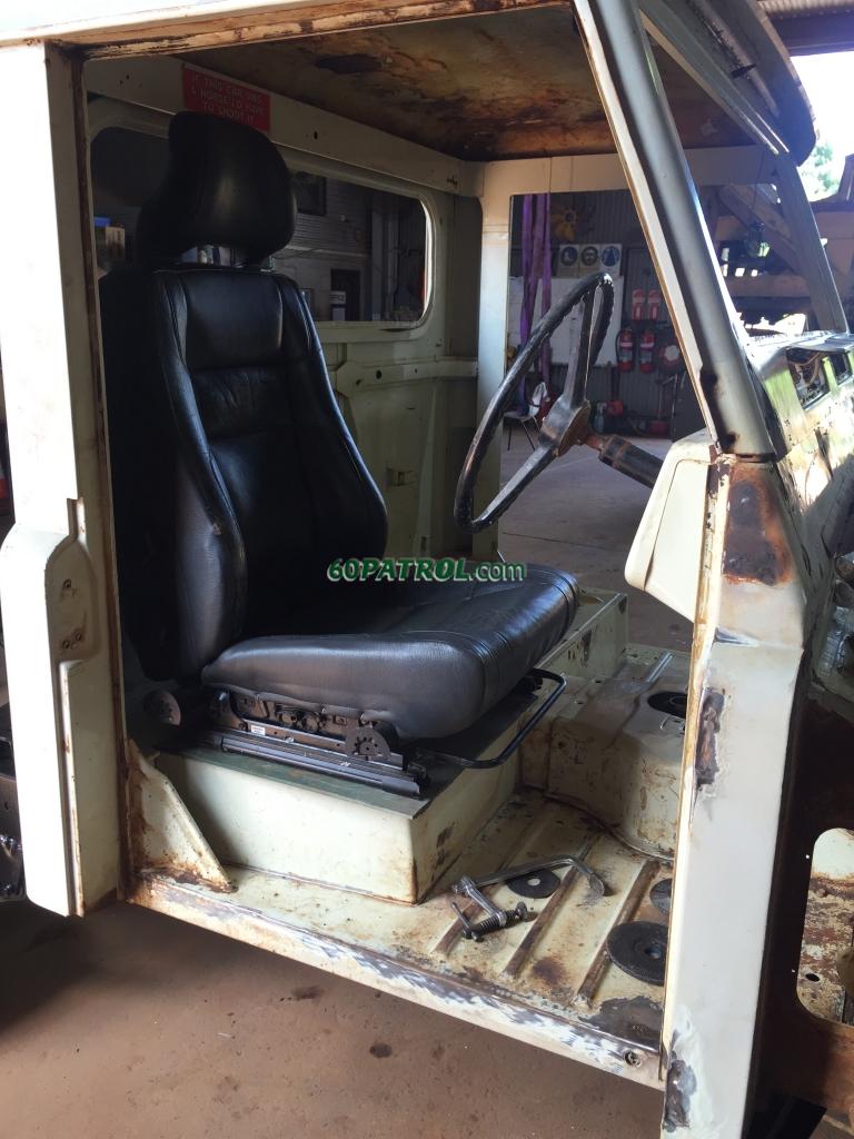

During the time of fitting the engine and the chairs we worked on fixing the rust which didn't take much only two small holes in the botto of each door, a hold from a spot light in my roof and a little strip down the back of my gutter which wasn't as much a hole but the rust need to be removed to prevent further problems down the track.
Choosing the paint for my car I went for the orginal ivory whitey colour before painting the cab I sanblasted it and primed it with high Quilty zinc primer to hopefully prevent any future rust.
whe painting the cab we also stripped down the chassis, sand blasted it and gave it a coat of a black chassis paint.

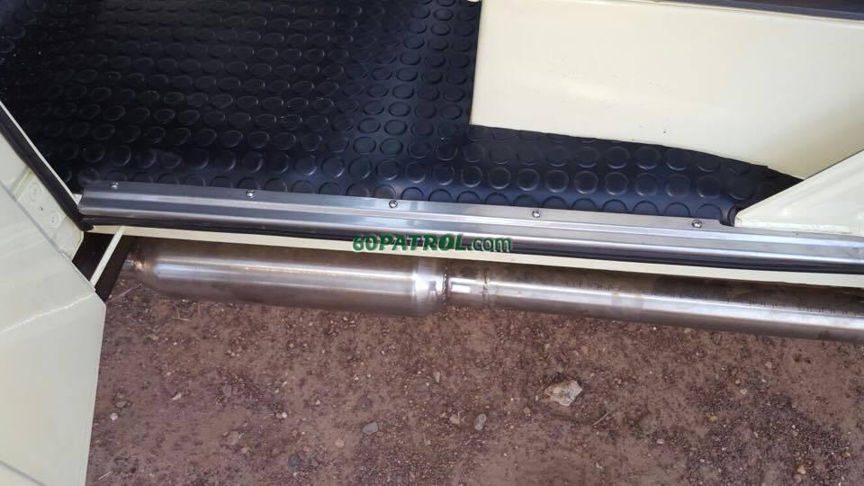

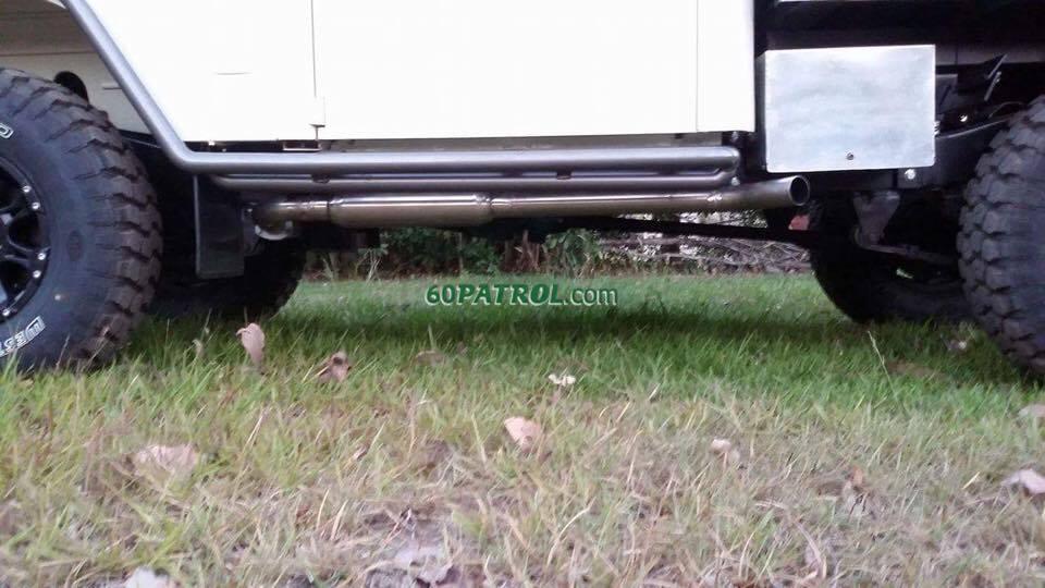

The stainless steel exhaust and alloy battery box
5132

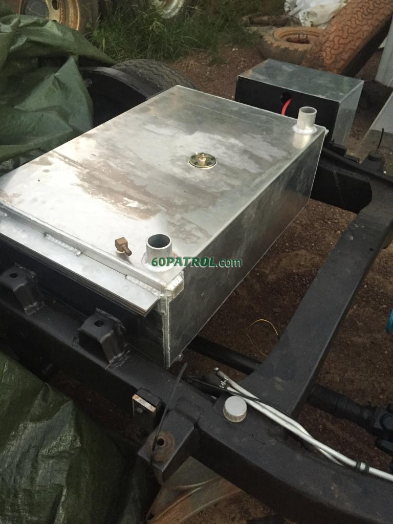

120L alloy fuel tank
5162

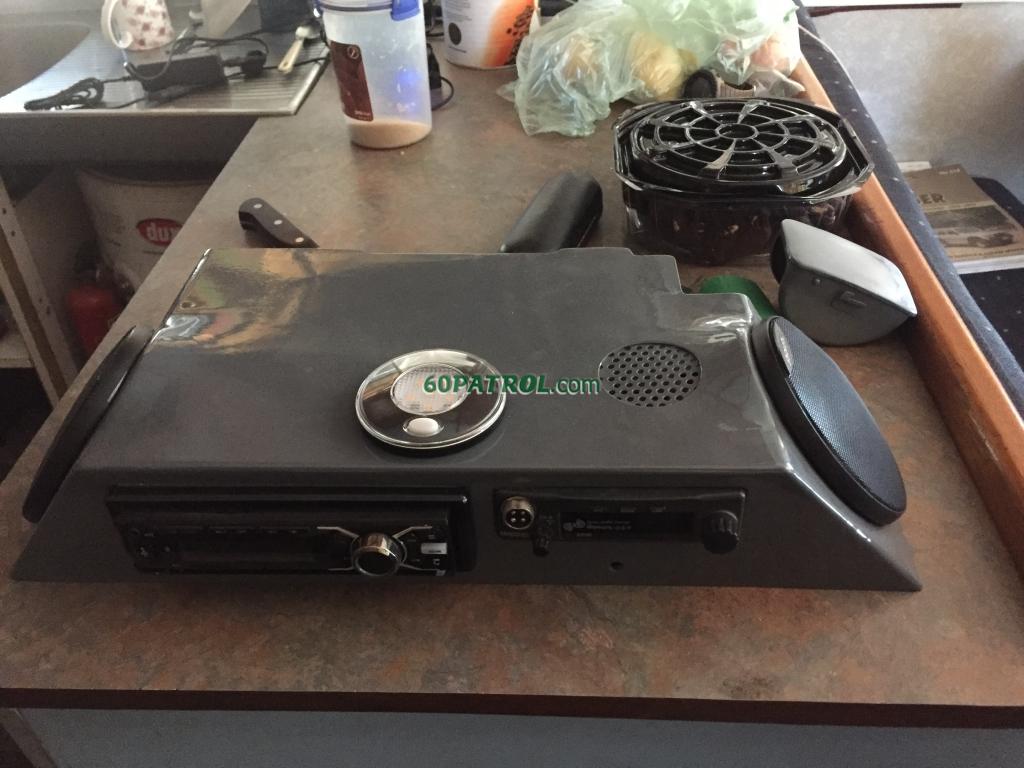

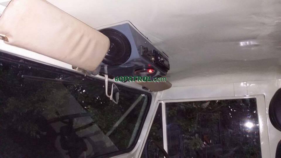

Roof centre console with radio, speakers and my two way
51485150

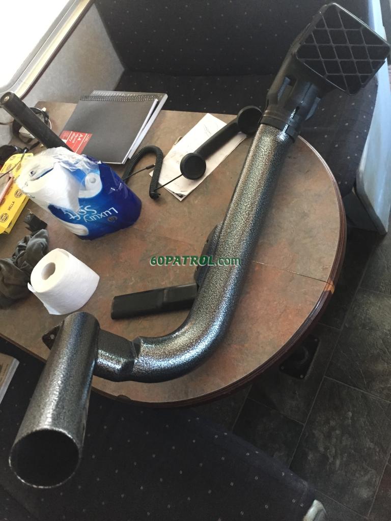

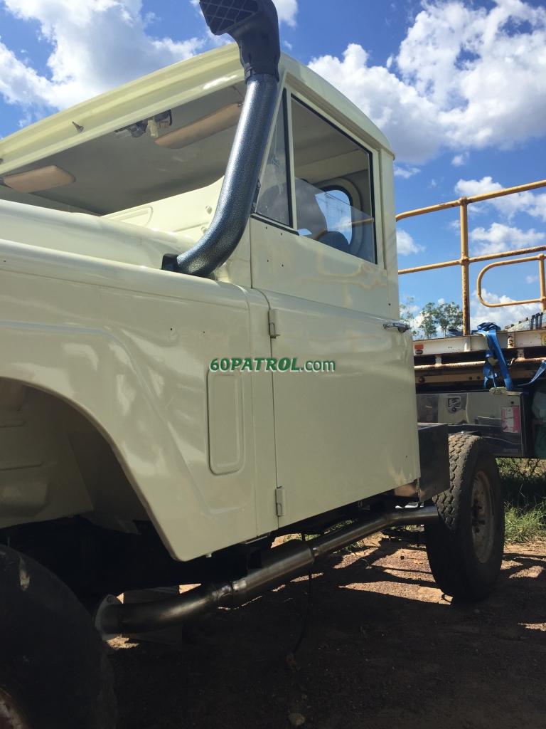

And the Snorkel
51495152

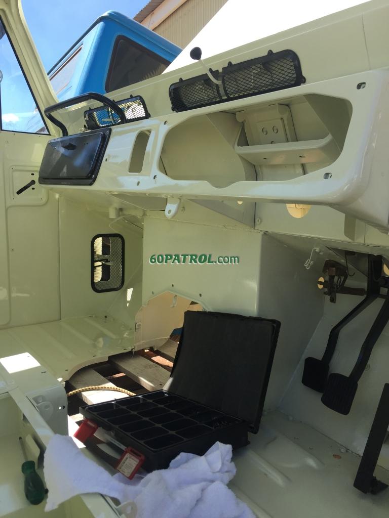

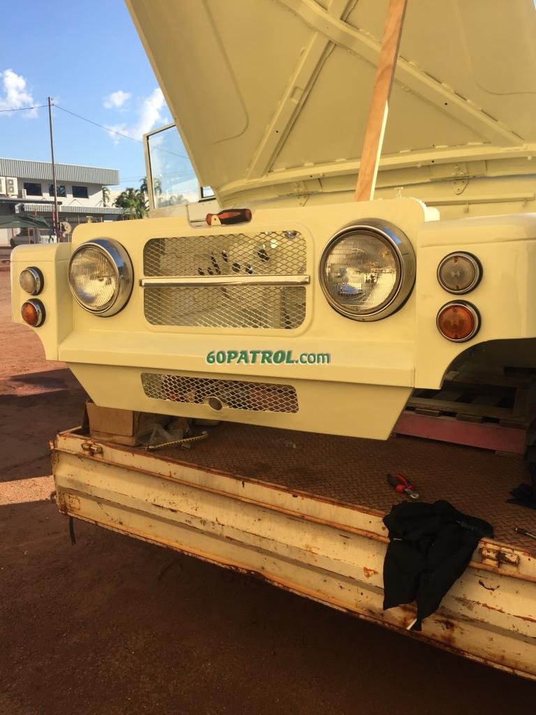

It's now May and I've been re assembling everything putting new rubbers for everything in
Made new floor mats
5154515351595158

Moving on...awesome job - love the turbo-diesel conversion, fuel tank, roof console, snorkel through the slot at the back of the bonnet, zorst, suspension with anti-inversion shackles...well, all of it actually ! Would be great to actually see a G60 on the road in SA - I'll keep my eyes peeled...

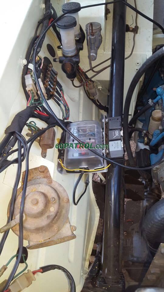

continuing on from before. during the assembly period we refreshed some of the cars wiring and wrapped in some conduit housing, while adding the we chucked in the new air filter which connects straight from the snorkel into the turbo.
5396539554285425

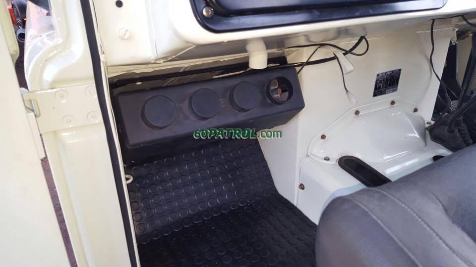

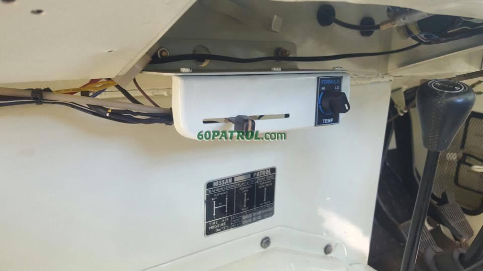

under the air filter the plumbing was added for the rather hitec air conditioner which most G60s probably don't see, removing the older heater system from the passengers foot well gave plenty of room for the new heater/cooler system. vents from a Tatra truck were added as these were small and could be rotated for blowing air in the cab and onto the window for a demister. the to control the air and modified switch was placed neatly under the dash to look nice and neat.
5400539554245429

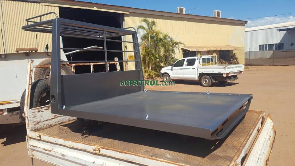

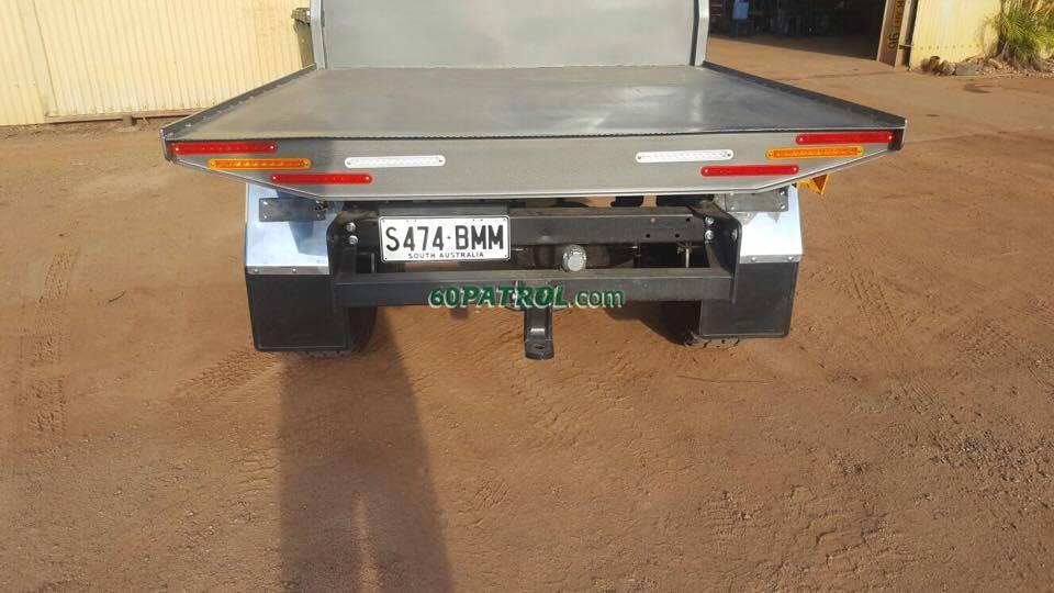

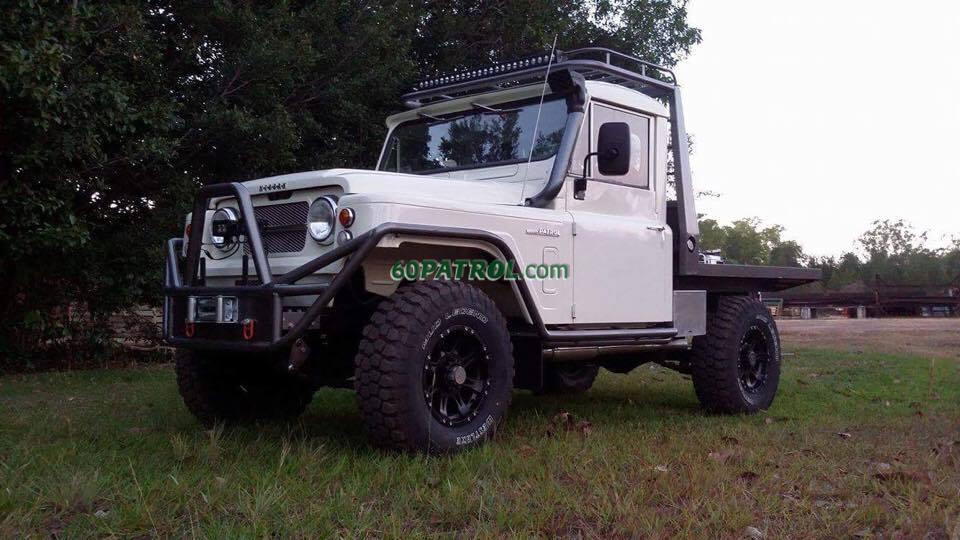

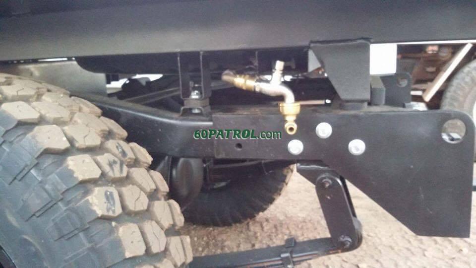

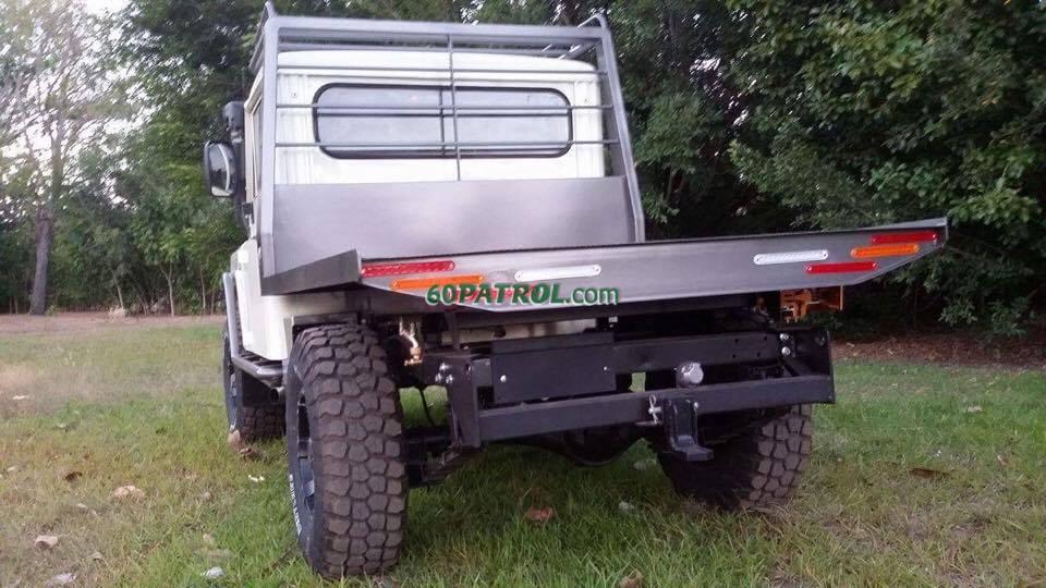

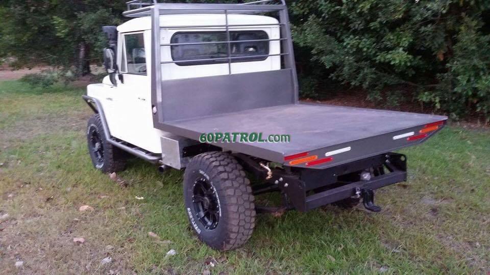

after the tinkering around and assembling the bar work and tray was built and finished off in a hammer tone silver. the bull bar rolls back onto a side bush bar then to some rock-sliders for some protection. Atop the rock-slider we added a checker plate side step also applying as a mudguard stopping mud from reaching the door. also as a nifty little touch a folded piece of stainless was added to hold my floor mats down and to stop shoes from rubbing away paint
539853995393542354275397

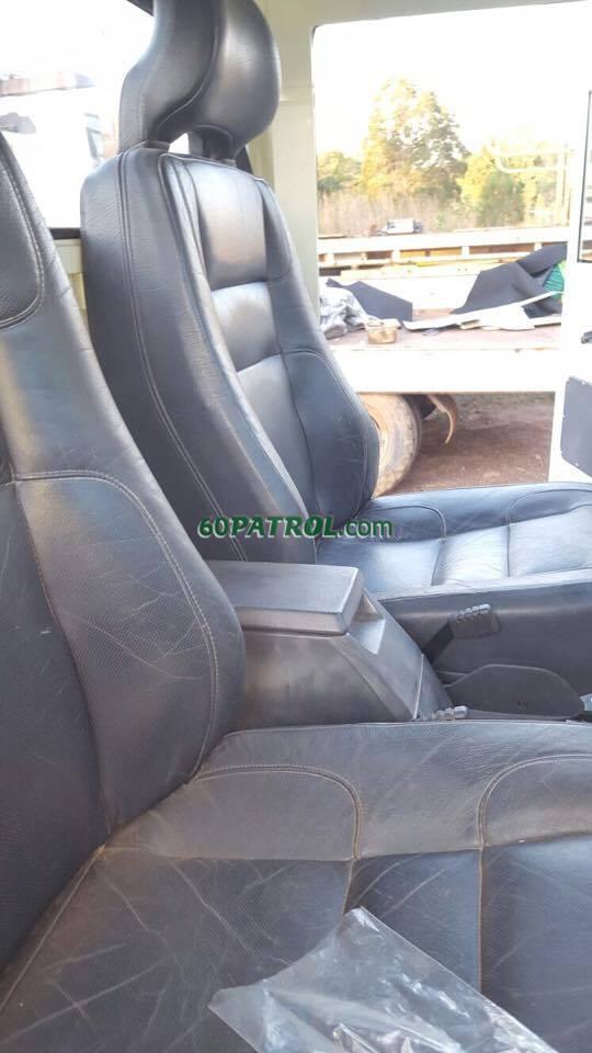

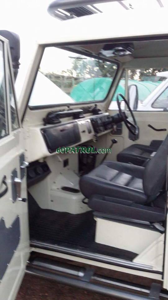

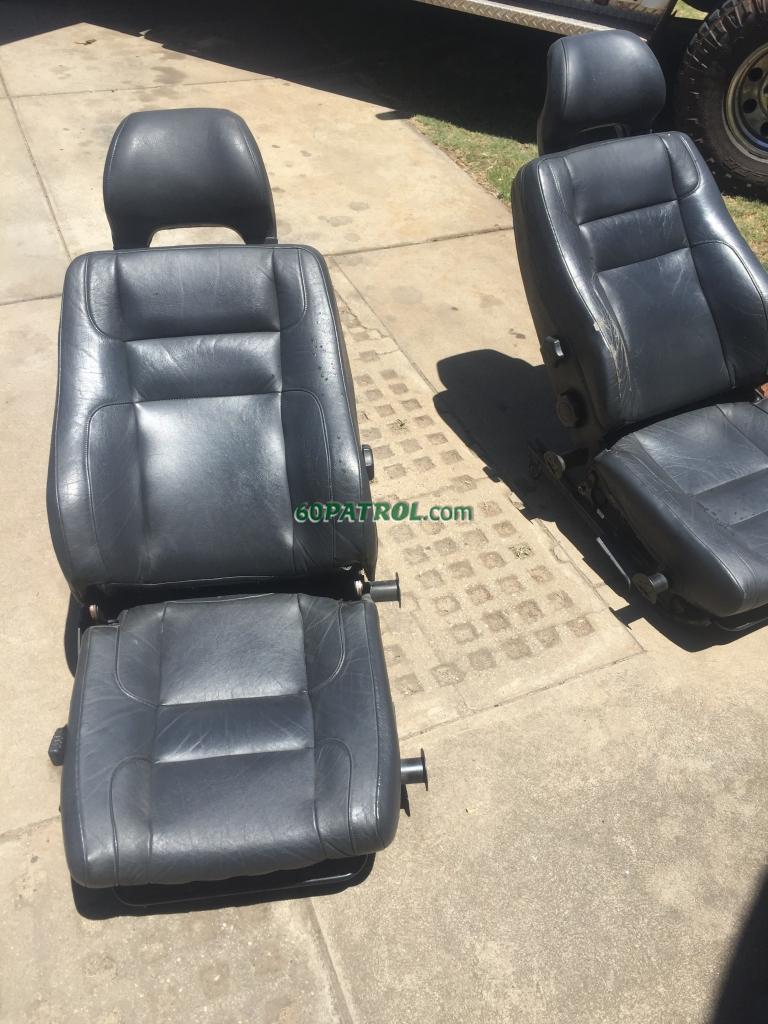

finally a the leather seats i picked from a old Volvo were fixed along with a console picked from a landcruiser
5409

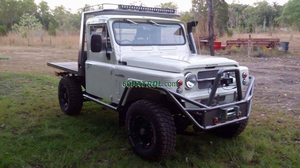

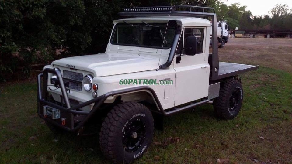

not long after this the tray was attached, bull bar and side bars went on, her new set of 33inch tyres on some black alloys rolled up and well it was looking a lot like a final project. we choose to go with 33s for now as it was more suitable for now and still finishing it off nicely. atop of my roof rack i added a single row LED light bar for some added light when offroading and for the high ways i added two small LED lights which are perched in the bull bars hoop.
540654195416541554225414540454035402

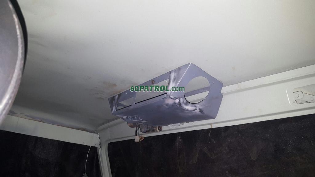

the custom stereo and 2way console added to the roof awaiting some roof lining
5410

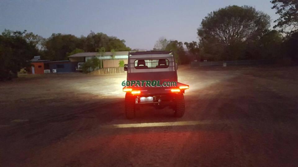

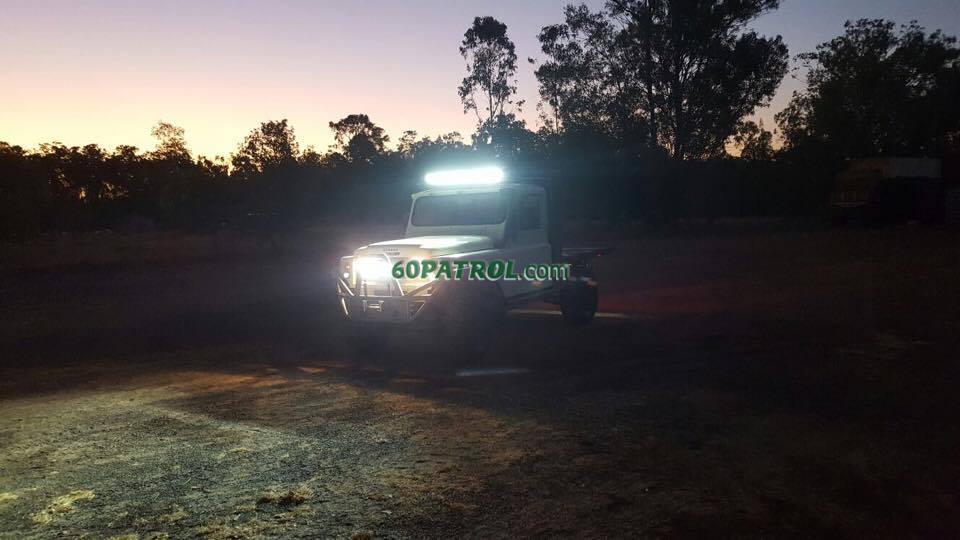

a few shots of her at night
54185417

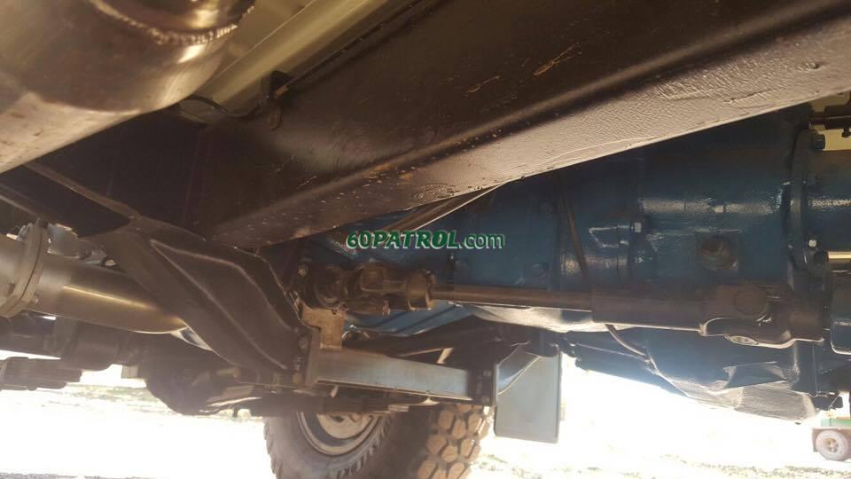

underneath the 120L fuel tank sits up nice and high. also pictured the pto shaft running from the gear box
54325431
some engine shots for those who enjoy the engine conversion sitting in nicely the 3.9L Isuzu diesel gets the job done
54305426
and well finally the last build photos where she gets her number plates back after a long 12 years. another G60 om the road and cruising happily at 90-100 and even giving some new modern 4x4s a run for there money.

:clap: :clap: :clap: Very awesome. 8-) Everything about it was done so well. The A/C looks like it belongs there. The bull bar and custom tray look fantastic. All of the extra details looks great.
I think the only thing you'll be unhappy with are the seats. They're a bit too tall and deep to work properly in the G60; it doesn't leave you much leg room. Good seats are difficult to fit in a G60. Someone found some seats that worked well once but I can't recall off-hand what they were, possibly from a Suzuki Samurai.

thankyou and yeah the a/c fits in nice and snug leaving plenty of leg room for passengers.
and the chairs are a little bit big for a tall human definetly but being on the shorter side of life i find them nice and comfy and quite up right :dance: .
