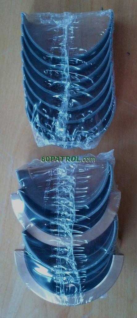

A closeup of the bearings
The Main Bearings -- I really hope these fit!

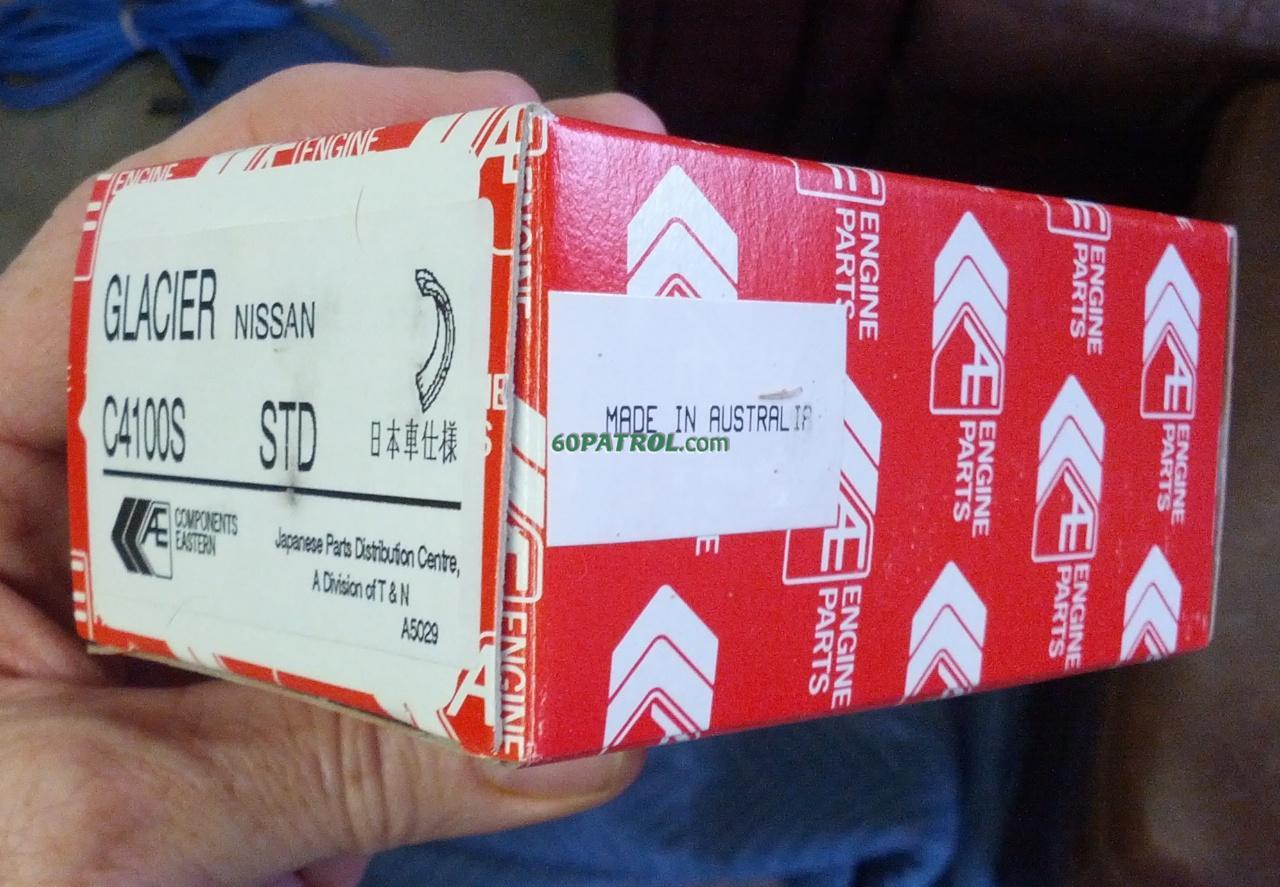

Sparta wanted to call my attention the place of manufacture, because...
The cam bearings were not made in Japan, rather, in that far off, exotic, foreign land known as Australia
Now, let's see what the machinist says about these!

Emily, my lovely wife, and I dropped of the parts at the machine shop today... on our way to a nice Valentine lunch at a fantastic local Thai restaurant. Anyway, I got to see our engine all cleaned up and in pieces... it looks really good! The head was indeed in great shape and only needed a simple valve grind to be tip top! It's ready to go back on right now!
I'm still a bit worried about the main bearings -- If I understand it correctly, the "early" P engine has a slightly smaller front main journal on the crank whereas on the "late" engine cranks, all the mains journals are the same size. Our engine is an "early" as it definitely has a smaller front journal. I just wonder if the the bearings we received also have a smaller first bearing... Dave, the machinist, says that the bearings look like they'll fit... but he'll call me if there's any trouble with it. Our engine should come up in his queue next week! We're getting close!

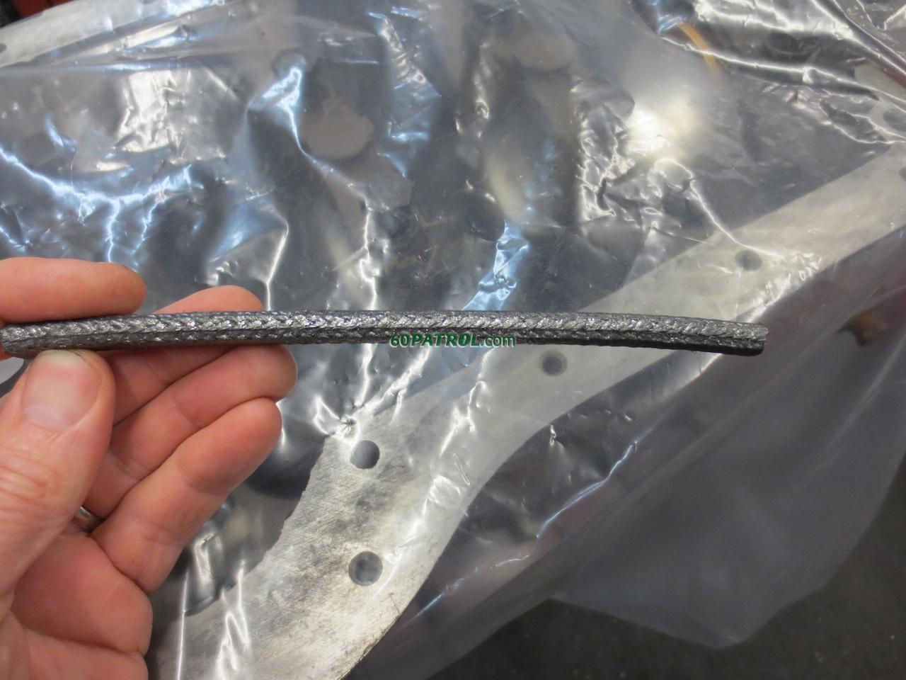

Rear Main Seal - It's too thick to fit into the groove in the block and main cap.
