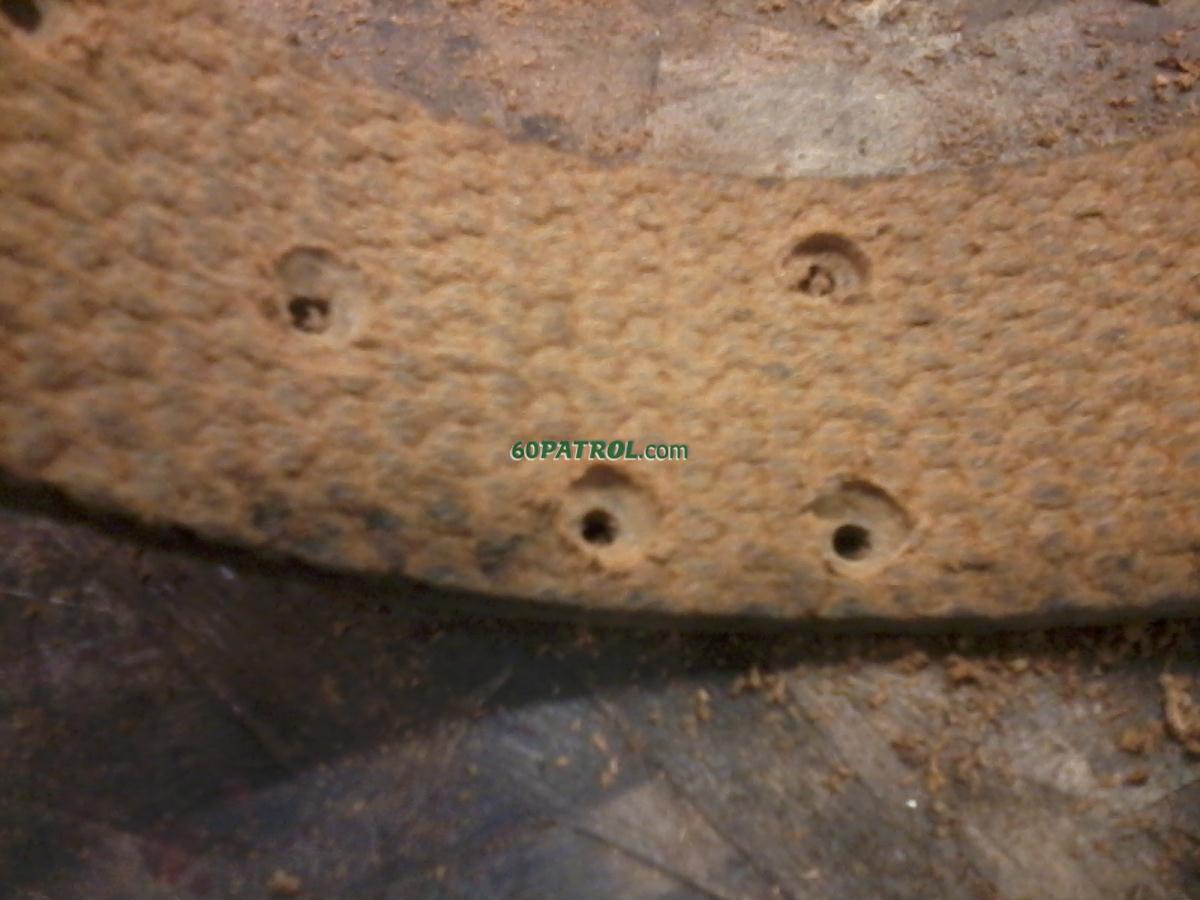

After pulling ling from the brake, finished drilling holes with 9/64" drill bit to fit the holes on the brake. Then I drilled counter sunk holes using a 7/16 drill for the rivets to sit in.
Final ready for reinstall. after riveting
Drilling holes part way thru without hitting drum
