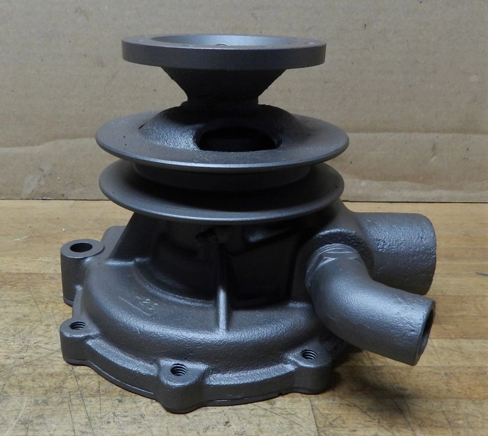

The 2nd Generation Website doesn't have a whole lot on it, but they do have pictures of water pumps they have rebuilt. Here is one that looks like a Patrol water pump, but I don't have one handy to compare:
