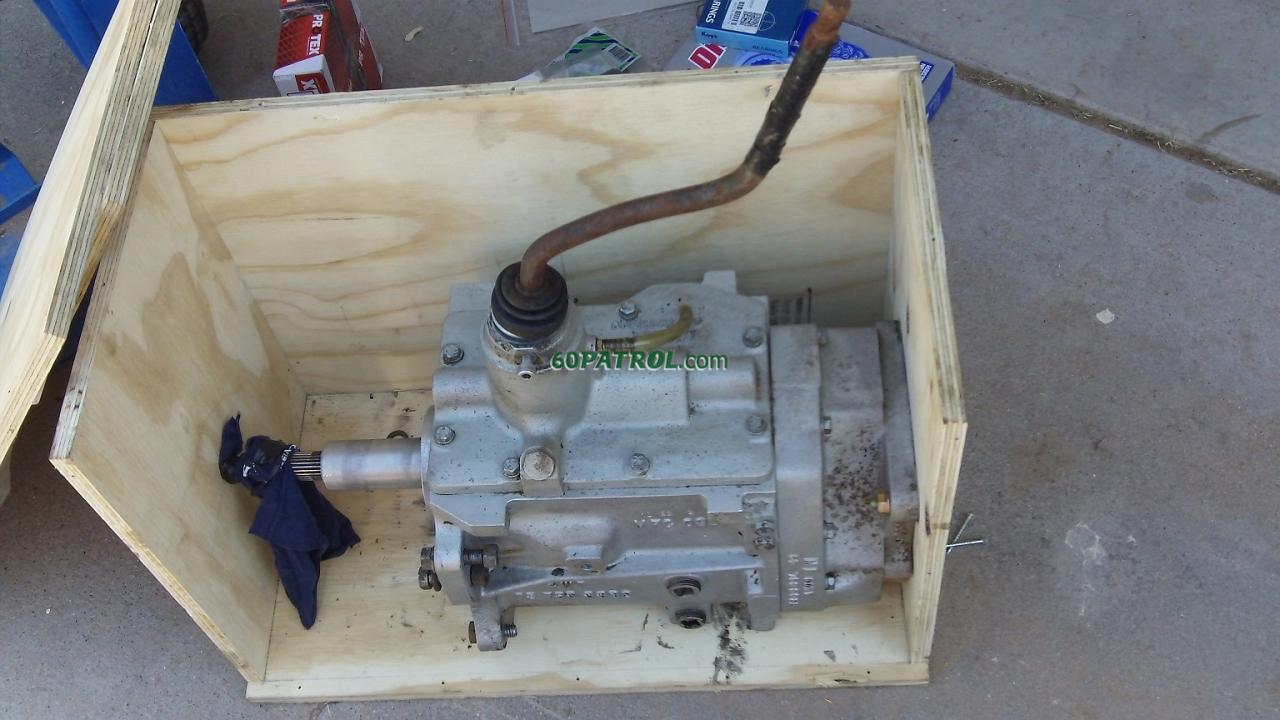

1756
Ahhhhh, the guest of honor has arrived, and with a bent shifter handle to go with it 8-) :
1758
Along with a bunch of other cool stuff- THANKS for the Ozzie video and reading materials, Tim! You know that IronMan4x4 Sticker will be going on my Patrol... 8-)

moore_rb wrote:Ok, Check it out....
This is not Tim Miller's garage, and that is not Tim Miller's Patrol in the background...
But the crate should look familiar. Hey Tim-- which side of this box is supposed to face UP? :lol:
Thats amazing how fast that shipping was!! haha yeah I have alot of trouble at work with our boxes getting flipped so its habit I guess ;)
moore_rb wrote:Ahhhhh, the guest of honor has arrived, and with a bent shifter handle to go with it 8-) :
Ahh yes you will need to cut and rotate that shifter handle to suit LHD :roll: Look forward to seeing the Ironman Sticker.. i think theres an ARB sticker in there too??
