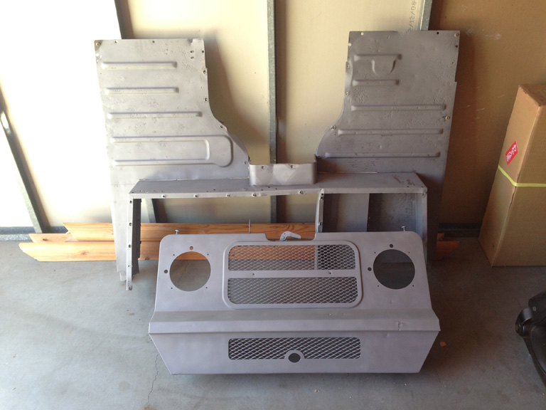

At the same time that I had the steelies blasted I also dropped off the spare floor and front end that Leslie had been so kind to include with the sale. Thank you Leslie!
Here they are afterwards, ready for primer (more on these later) :

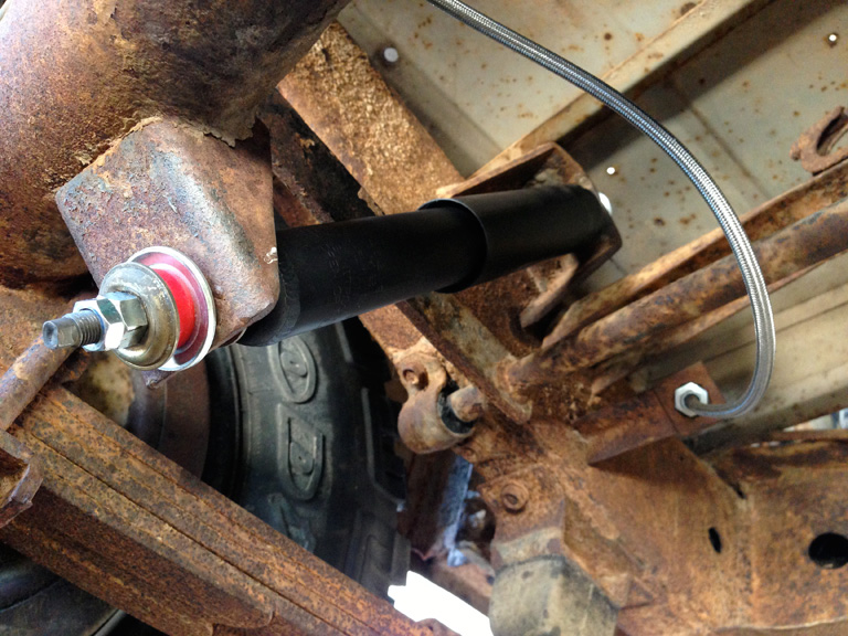

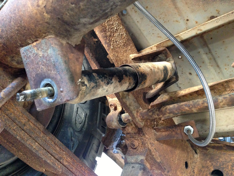

Started on the bushings and struts last weekend.

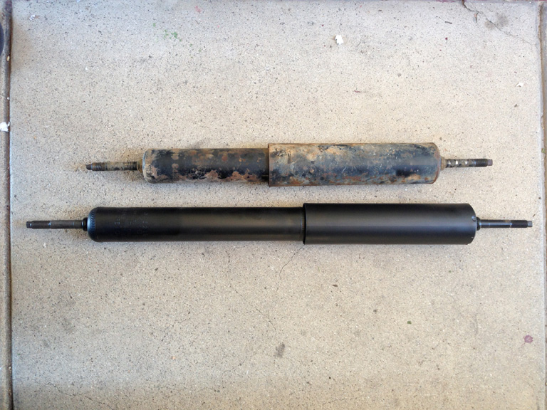

Out went the deader than dead Nissan KYB originals:
And in went modern day KYB replacements:

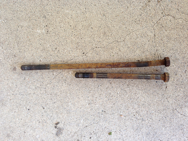

Only casualty at the back were the 9.5" ~ 10" rear swaybar end link bolts - both were bent.
An order to McMaster fixed that.

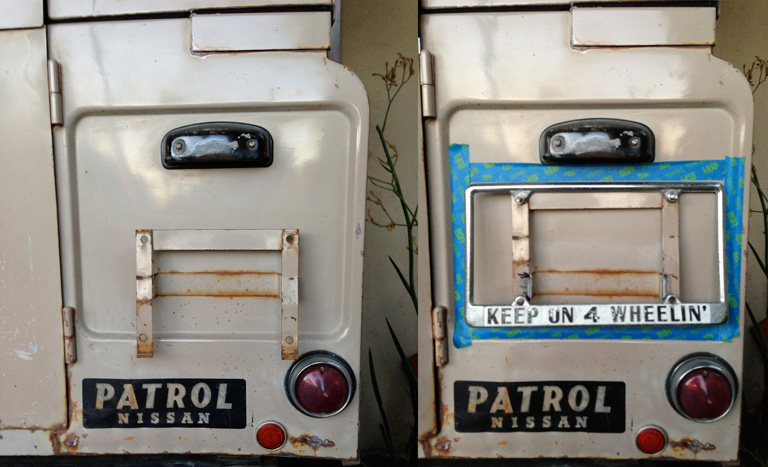

While I was at the back, I had to do a minor mod.
Something that has always bothered me on Patrols - I apologize to the purists right off the bat...
Cut, align, re-weld:

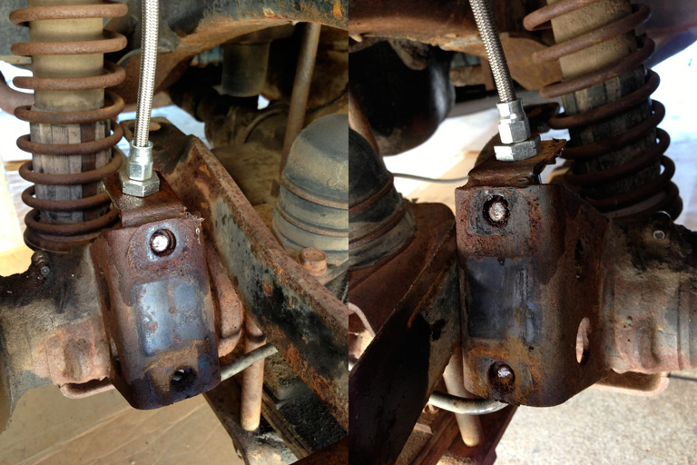

Moved to the front suspension and there things got interesting...
Even with liberal amounts of penetrating oil, I successfully snapped 3 out of the 4 front swaybar bracket bolts - nice !
Drilled out and through bolted. Done.

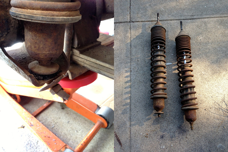

Went to remove the aftermarket front coilovers and had similarly amounts of fun. Driver side had the bottom threaded rod bent over due to a rock strike, passenger side twisted right off.
The coilovers have a Made in USA stamp, a UP Arrow stamp, and a part number 81057 - 56920.
Couldn't find out anything about them on Google, but I didn't search all day and all night either...
They are still surprisingly stiff. Do these have any value to anyone for spare parts (the hats and the coils?).
If not, I'll just toss them.

Nice work. Where did you locate the KTB replacement shocks, and what was the part number? They looks identical to the NOS replacement shocks that used to be available form Nissan.
Patrols are all SAE. About the only metric I have found on a Patrol was the nuts under the distributor; they're 10mm as I recall. Nissan didn't switch to metric on the Patrols until sometime in the mid 70's. I think Swerve posted the year for the change once.
I the documentation that went with PFP there were the warranty cards for those front coil over shocks. There was a manufacturer name and info on them. I remember researching it once and not coming up with much other than an ad in an old magazine.
I like the realignment of the license bracket. The squared stamp in the rear of the tub stared in '68, and it really did make the license look off kilter.
Broken bolts are the bane of every Patrol.

The KYBs are the ones that are carry over for old Mustangs and that bosque posted about a while back - KY343219
Got them from summit racing for $22 ea

I like it, good subtle modEricB wrote:L
