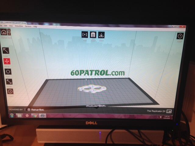

The stl file is created in Makerware (my preference, there are other programs available)
5361

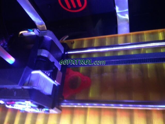

Here's the printer in action. 20 or so minutes for this part.
5363
