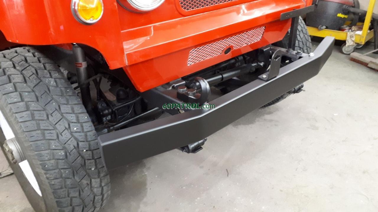

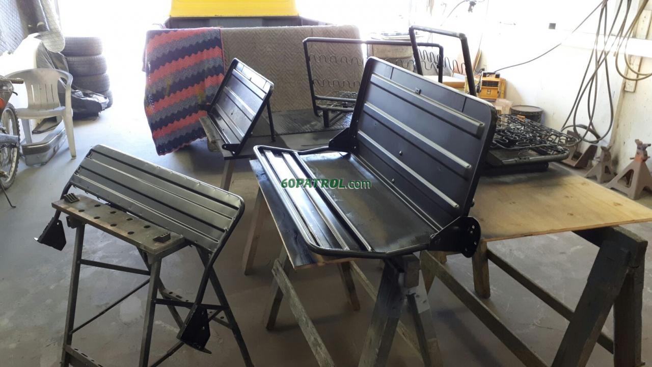

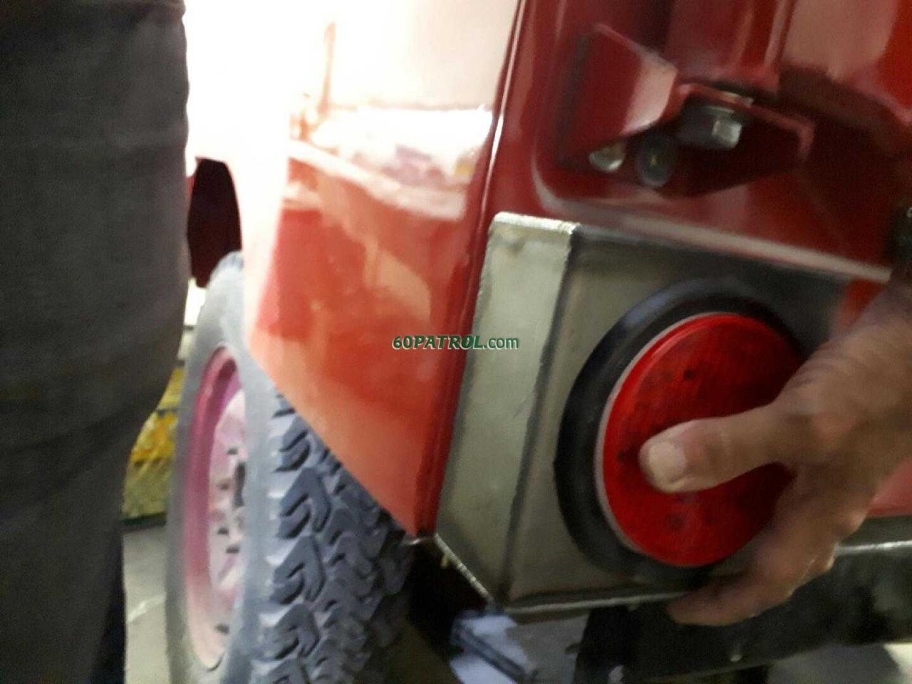

A lot of work got done since the last updat...
