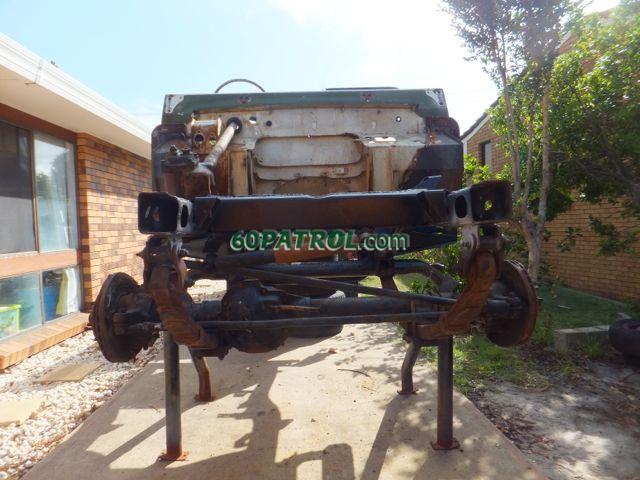

Picked up a pair of front MQ springs, shackles & u bolts from the wreckers the other day. Today I slung the front diff up and hung the springs, I had to move out the front hangers out 10mm either side just like Swerve said. I used the G60 steering linkages, had to adj them a fair bit but it all looks like it will work

Disc brakes!
Looks like it's pretty easy to work on with no body or engine getting in the way.

Conversion looks like its coming along nicely! Well done

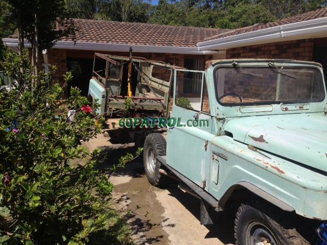

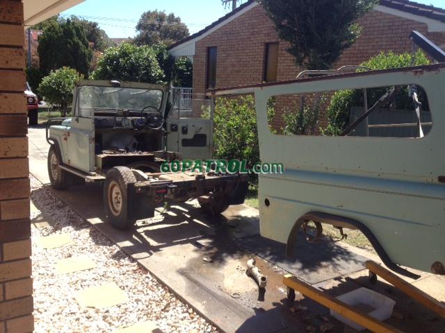

Removed the rear tub & roof off the 1970 Patrol I got a couple of months ago to go on my 74, flipped tub over and checked floors, all ok. No major rust just the lower rear quarter panels & top of roof frame, fiberglass roof ok
