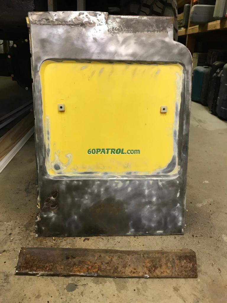

so i mustered the courage to get out the grinder and do some very precise surgery. I ended up removing the entire rear passenger side panel. Note the piece of rusty sheet metal on the ground. It was being used to reinforce the structural piece that attaches to the frame. It was what caused the panel to be slightly askew when welded into place.
7176
So, when that is taken out, one can see the real issue - that structural support on that side is pretty much gone. I'm glad I did this as this would have certainly come back to haunt me in the near term had i found an excuse to ignore it. In looking at the driver's side, it doesn't look like it is compromised and doesn't look like it has a similar sheet metal patch in-place. I am going to get rid of all of the paint/body filler though just to verify. If it is shot as well, I will replace the entire structural piece. If it isn't, then I'll just repair the passenger side.

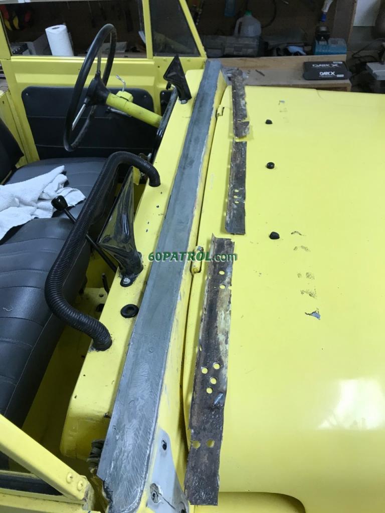

I have to wait on the new sheet metal brake coming in before fabricating up replacement panels for the bed. In the meantime, we moved our attention to the windshield sill. It had some rust in it and is probably a good place to start with our first patch panel. if we mess up, it is going to be hidden when the windshield is re-installed. We have to to a repair on both the passenger side and drivers side. We started with the passenger side. We got it all cut out, and the new sheet metal ready to go.. unfortunately some idiot left the valve open on the argon so we'll have to wait to do the welding until next week

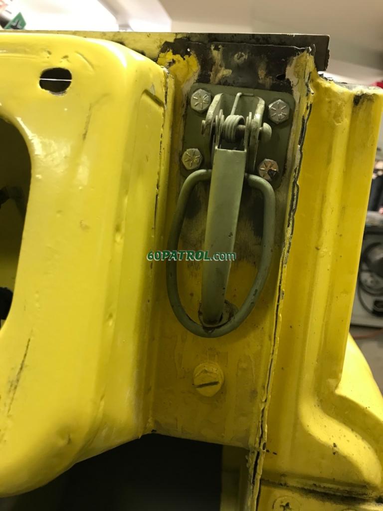

We had a good surprise today. There were no holes for the windshield latches. i thought they would have been welded up when the hard top was installed. When we opened up the hole in the windshield sill, we saw the original bracket was still in tact. After grinding away the paint and bondo and retaping the hole.....
7177
I bought these brackets on ebay a long time ago. Look pretty good in their new home.

After being patient with stitch welding and lots of grinding, the new metal is in place on the cowl. I took it out in 3 pieces. First i replaced the pax side and the drivers side at the same time, but left the middle piece in. Once the Pax side and drivers side pieces were in, I replaced the center. I'm sure it was plenty strong and I could have done it all in one go, but I was being cautious. It's pretty ugly, but it will work. I'm glad I got some practice in on a panel that no one will ever see.
Also happy to have gotten the hing latches attached. The drivers side bracket was more problematic than the pax side. there was a broken bolt underneath a ton of bondo. Since we had the top of the cowl opened up, we removed that bracket so we could remove the bolt and retap. Good as new. Again, lots of work that is invisible.
Next up, apply a few coats of epoxy primer. Spot weld Raul's canvas top bracket onto the new (old) windshield frame. The priority right now is to get that windshield frame installed and functioning, then we'll turn our attention to the back of the truck.

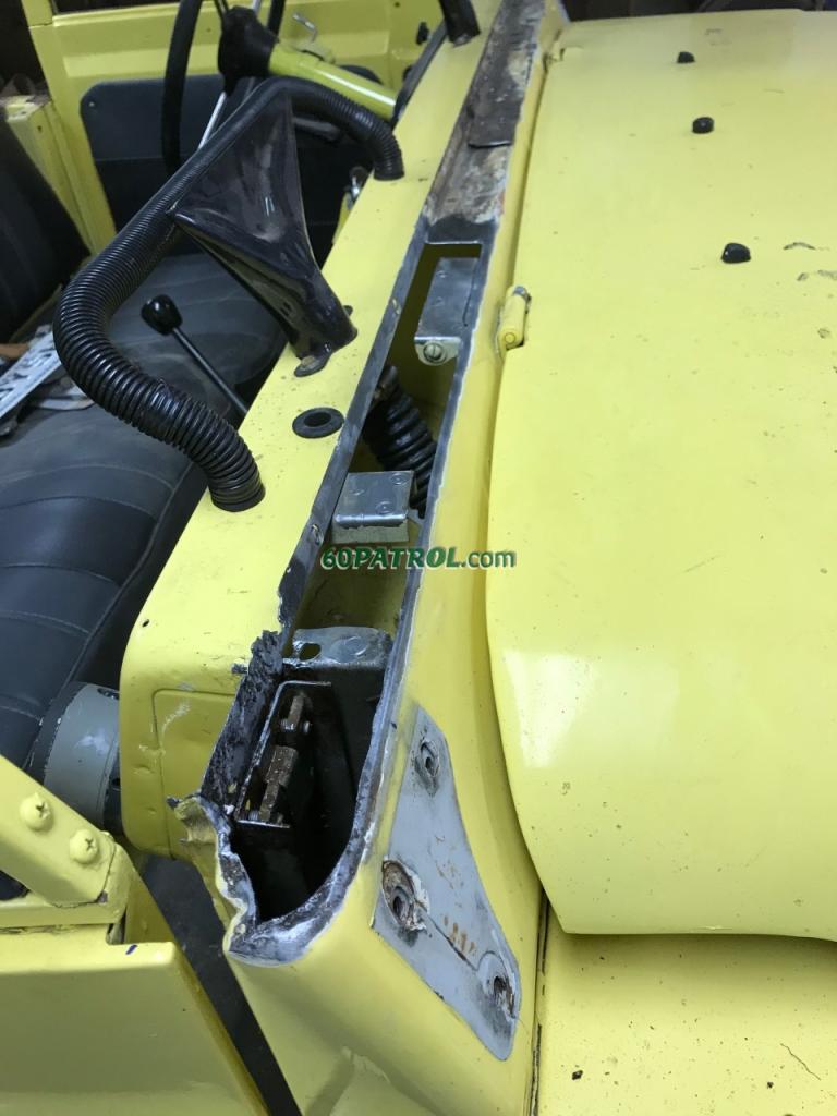

When I was grinding on the cowl, I leaned too hard on the hood and heard a pop. Looks like I broke through whatever adhesive was used to secure the hood brackets to the hood skin. Anyone know what this stuff is?

It looks really good Don. Congratulations. :clap: :clap: :clap: Good thinking about practicing there, and the results look very good.
I've known this products from Sika, that can be the solution for the separation of the structural ribs under the hood:
https://automotive.sika.com/en/solution ... lants.html
The have there an "anti-flutter" adhesive SikaSeal®-710 LS2 – medium expanding, specifically designed among others, for hoods body structure. It's a single component product.
I'm sure there are other products from different manufactures, and the literature above will help you.
