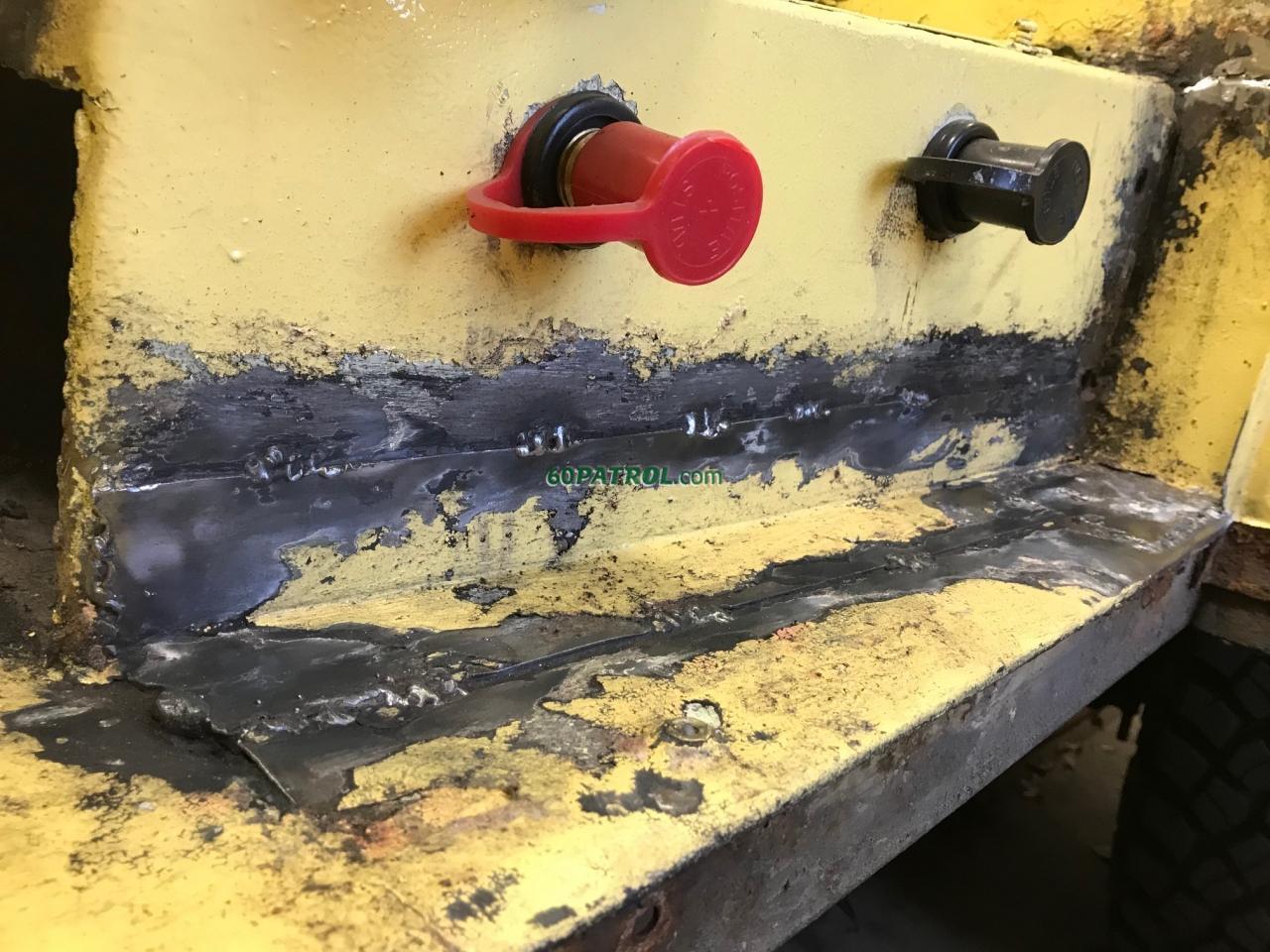

So, today - 4 months post-op, I started working on the Patrol again. Just a little bit. It's amazing how long it takes to get one's strength back. I feel good though and am glad to have the Patrol project. I started by removing the welded on sheet metal that connected the seat box to the floor and rear tub. The first picture below is with a little paint removed before a lot of grinding. The second is with the sheet metal removed. There's some rust hiding in there, I'm sure it'll be worse than it looks once I get all of the paint removed. There is more of this sheet metal "support" in a lot of other places, so I'm going to get back into practice with the grinder in the days to come.
Couple of questions for this group:
1) I need to remove the bed, do I need to remove the seat box first? Is there just the 4 bolts holding the bed down? I need to remove the bed so it can be sand blasted to remove all of the undercoating and to identify all of the cancer spots.
2) How is the seat box attached to the floor pans? spot welded?

Welcome back! Glad the surgery and recovery went well for you. Nice to see you're back on the Patrol.
It is not (normally) necessary to remove the seat box to remove the tub. Just the 4 bolts secure the bed. There might be some bolts connecting the seat box to the tub but I don't recall exactly. With the history of mods on yours it wouldn't surprise me if the seat box is welded to the tube though.
Pretty sure the seat box is welded to the floor. But your looks like it's had some reinforcement added so it's hard to say where else it might be welded.
