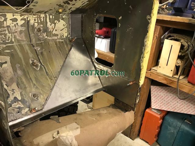

Tonight I found the house empty and I was motivated to do some work on the Minion Missle. I fashioned some replacement panels for the Pax side footwell. I have some cage nuts to weld in place and then I'm going to hand this off to #1 daughter to weld into place (she's a much better welder than her old man)
Next up, I need to replace the internal nut assembly for the door hinges. Somehow, the lower hinge on the pax side was attached without this being there? The top side also needs to be replaced because I broke the bolts off when I took off the hinge - totally my fault.
Once I get the new hinge nuts in-place, there's some structural work to do with the actual pillar as it has completely rusted through
