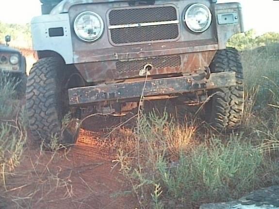

So I couldn’t find another original rear axle. Back then all we had was the MSN group. An FJ40 axle has the same gears, same lug pattern, and it’s only 2” narrower. For springs, I thinned out a set of 52” springs from a 73-87 GM C/K-10. It fit 31x10.5” on FJ40 15” wheels. It was a very capable and fun rig.

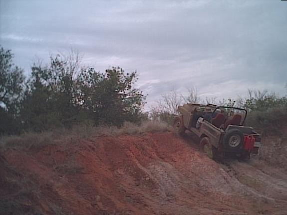

Wheelin on 31’s was fun, but all of my friends had taller trucks, so I figured it was time for a spring-over. We took it out for a spin, experienced some axle wrap, and and found the weak link. The FJ40 pinion gear twisted in two! A buddy hooked me up with some Dodge 3/4-ton axles, and we swapped them in. We had to outboard the front springs and we stretched the wheelbase to 100”
