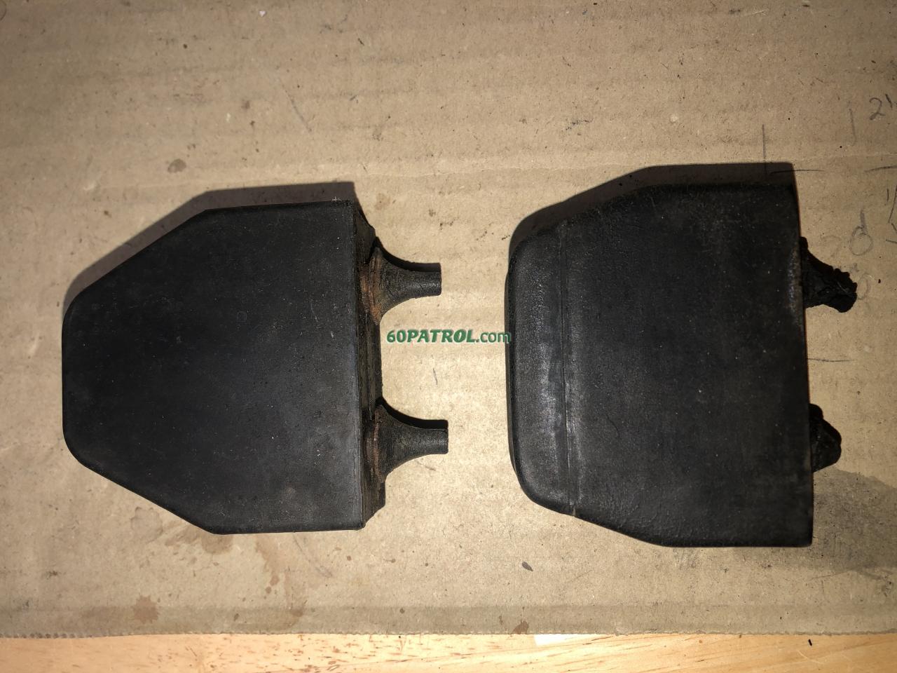

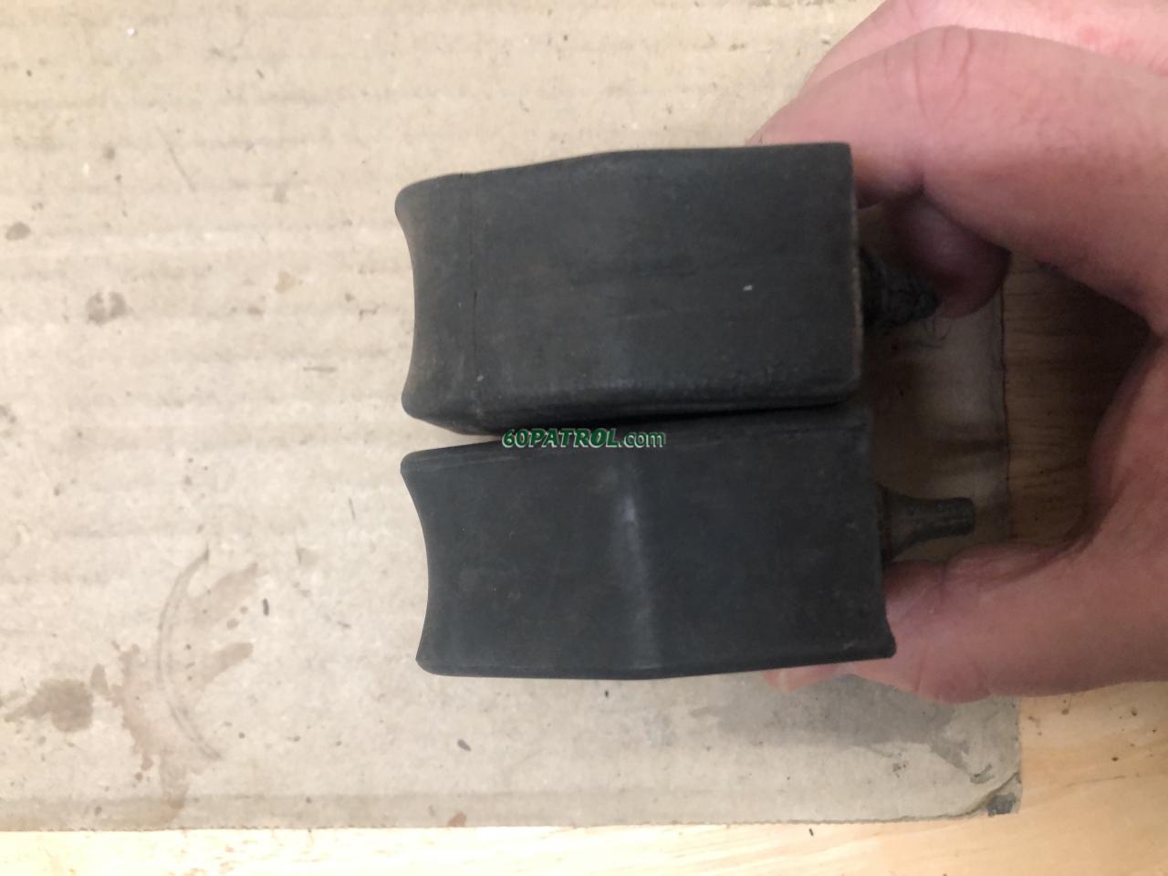

I have identified two (2) styles of Hood Windshield Bumpers:
Keith88238824
Can anyone identify the application years of the different styles?
Thanks,
