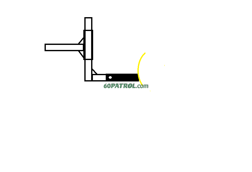

Here is the plow design I have in my head.

Daaaam! 1/4" will be monstrous! I have seen a few custom bumpers on Patrols, and most were pretty beefy but I don't think I've seen 1/4" used yet. You might want to re-think those spring leaves before you order them.
I can attest that 1/8" square tube will puncture a hole in a Jeep 1/4 panel..
