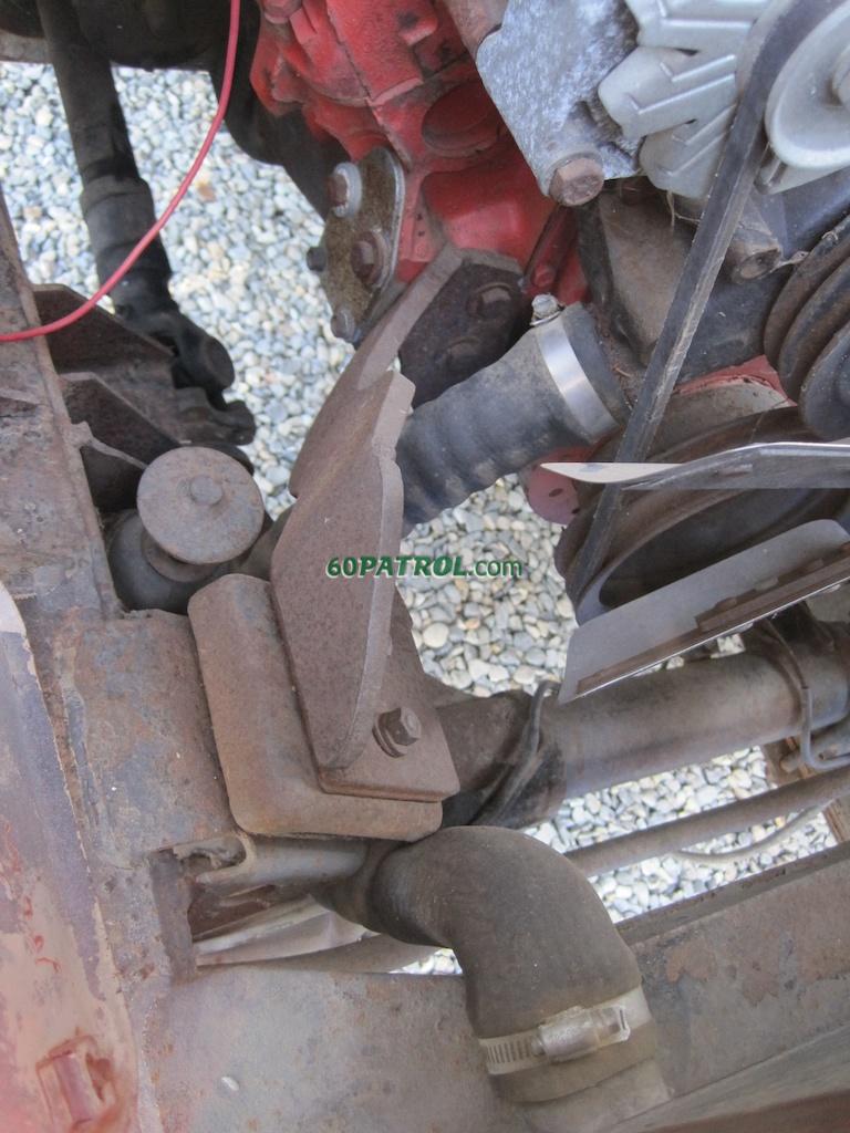

Family Patrol Update -- Since I ended up with three more Patrols since my original post, I'm now the proud owner of THREE P engines! We've started pulling the engines out and will be doing a minor rebuild on two of them for our two '67s.
I've received a couple of questions about the Chevy V8 and its motor mounts. I think it causes too much damage to the firewall. Man, they hacked it up big time! I'd be game to keep the V8 if they'd done a nice job, but... Yuck!
Take a look at that gaping hole! It's just as bad on the other side!

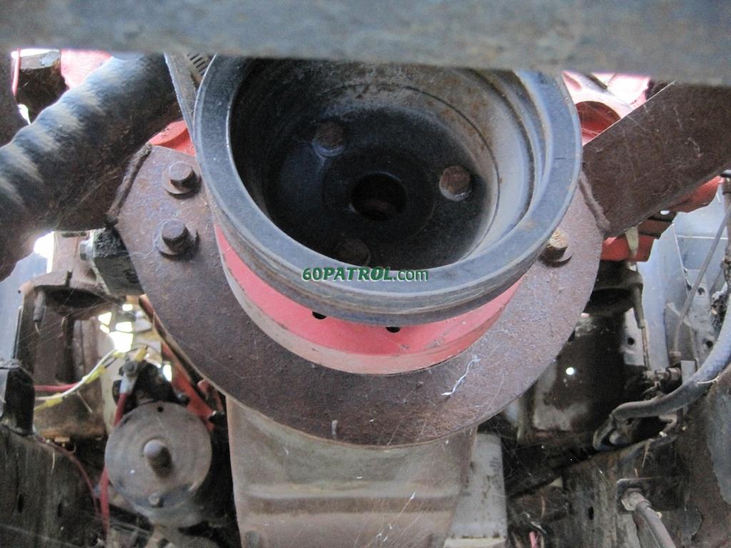

However, the motor mounts are pretty cool. It's a one-piece mount that swoops down under the harmonic balancer bolts to the front on both sides.
Not being familliar with Chevy bell housings, I have no idea where this came from... Perhaps someone will chime in here? The bell housing has a shaft for the transfer case levers and some sort of bolt-on, possibly for the E-Brake?
It's likely to be a few months before I take a wrench to the '67 soft top (We want to get the orange '67 running ASAP!), but I'll post close ups of the bell housing and front mount (unless someone want's to help out a bit...
Thanks!
John
