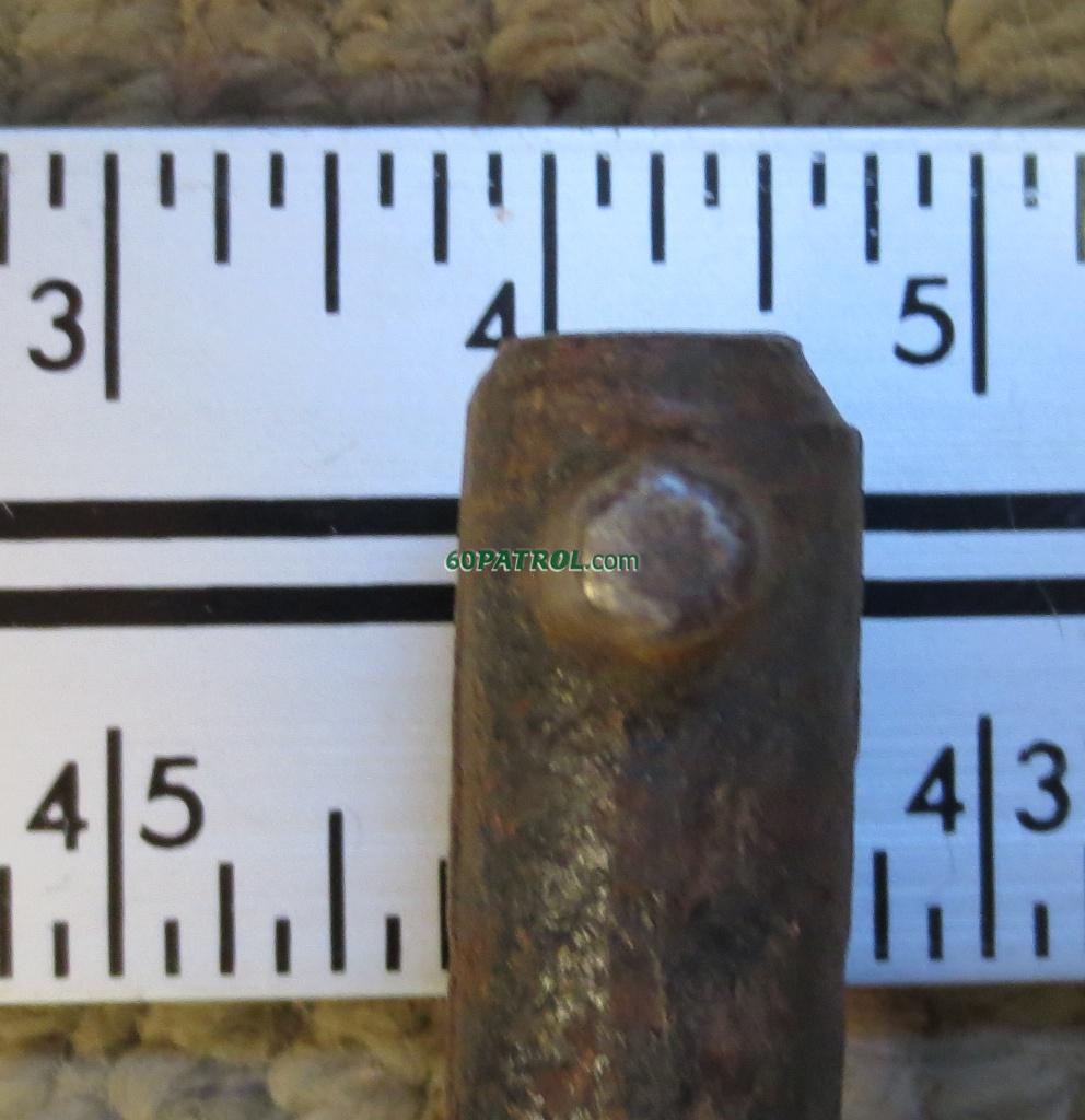

GARYSCC wrote:I was also wondering how to safely manual start the patrol. I have heard stories of guys back in the 1930s getting broken hands while manual starting the Ford Model A's. I understand that I will rotate it clockwise, and I don't want to get my thumb caught in case it whips backward counterclockwise.
The crankshaft nut where the hand-crank engages, is made in such a way that when the engine starts, if forces the hand-crank out, so that part of the process is safe. However, and this I'm quoting from Wikipedia (I'm lazy today)
...The behavior of an engine during starting is not always predictable. The engine can kick back, causing sudden reverse rotation. Many manual starters included a one-directional slip or release provision so that once engine rotation began, the starter would disengage from the engine.
