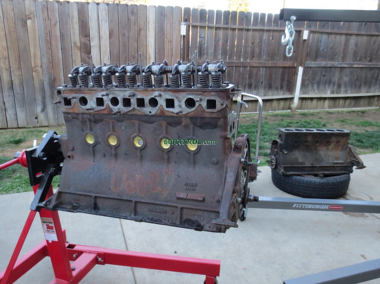

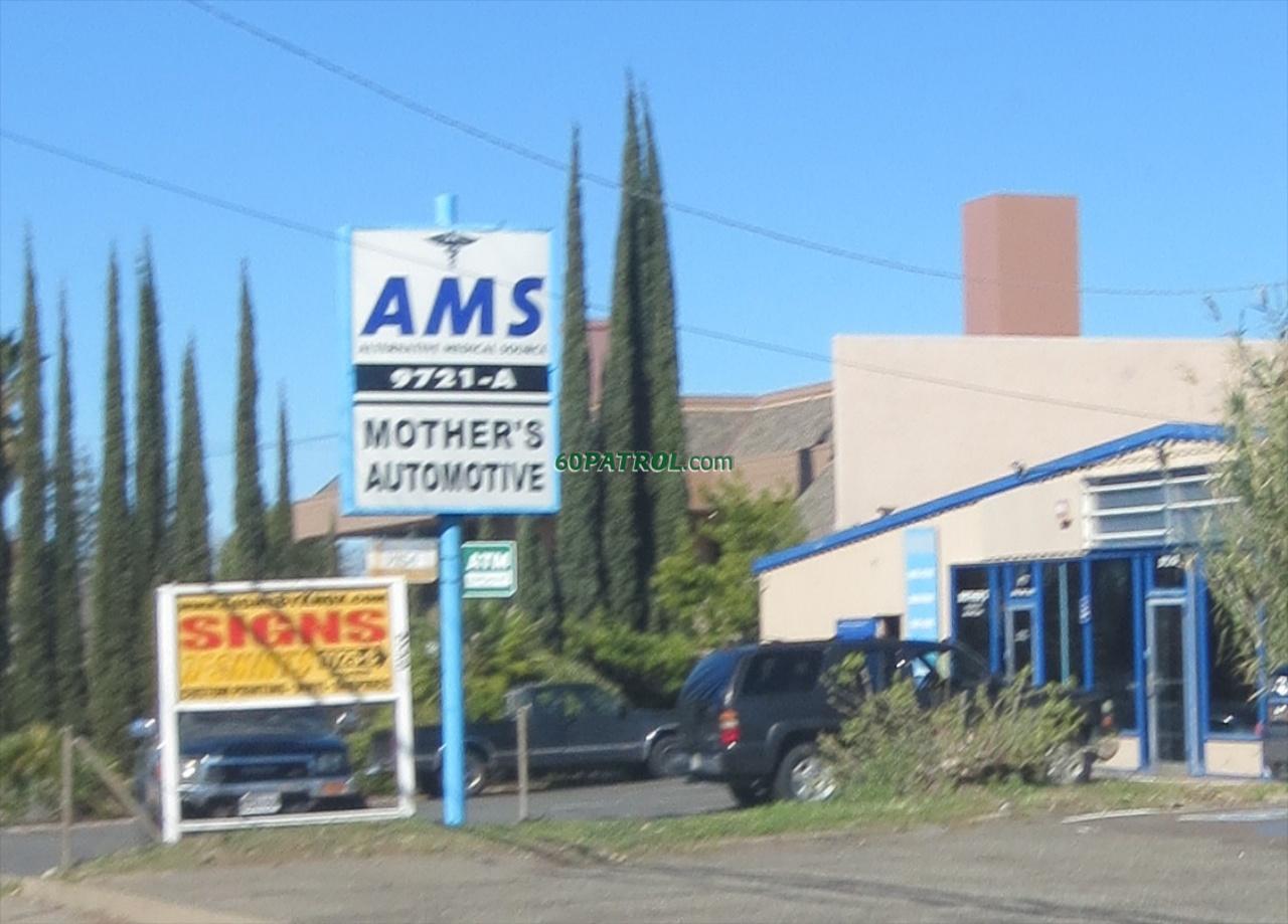

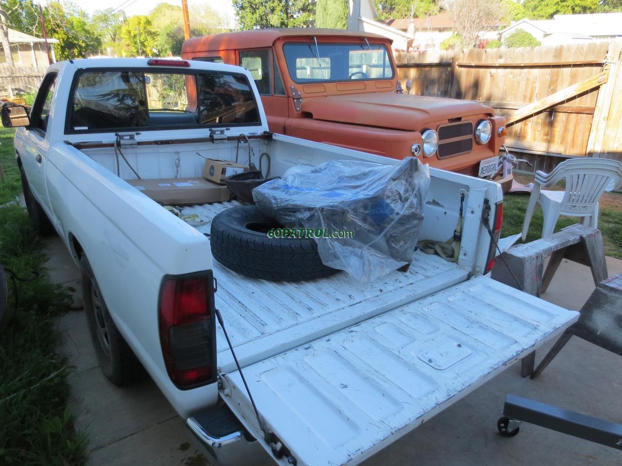

It's done! We picked up the engine from the shop yesterday... Took some "creativity" - including removing an entire section of the fence to squeeze my little pickup truck onto the back patio to unload it.
Sorry that the picture is blurry -- but that's Mother's Automotive there on the left.
A tight fit all the way back to the patio
More of the squeeze
Safely unloaded
I suspect I should have/could have picked a better way to bolt the chain! Whew! I was lucky this didn't break and drop the whole thing!

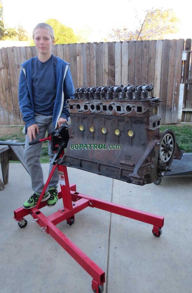

A front view --
A side view -- I'd better get that Nissan Blue on soon!
The Valve train
Joe thinks he's going to be the first to drive it... Wanna bet?

Have you figured out what the large lettering on the block indicates? In the side view and front view of the block you can see some large lettering on the block... hmmm...
as far as paint goes... you could go all rat rod on us and not paint it...
nah... the blue would look so much better..

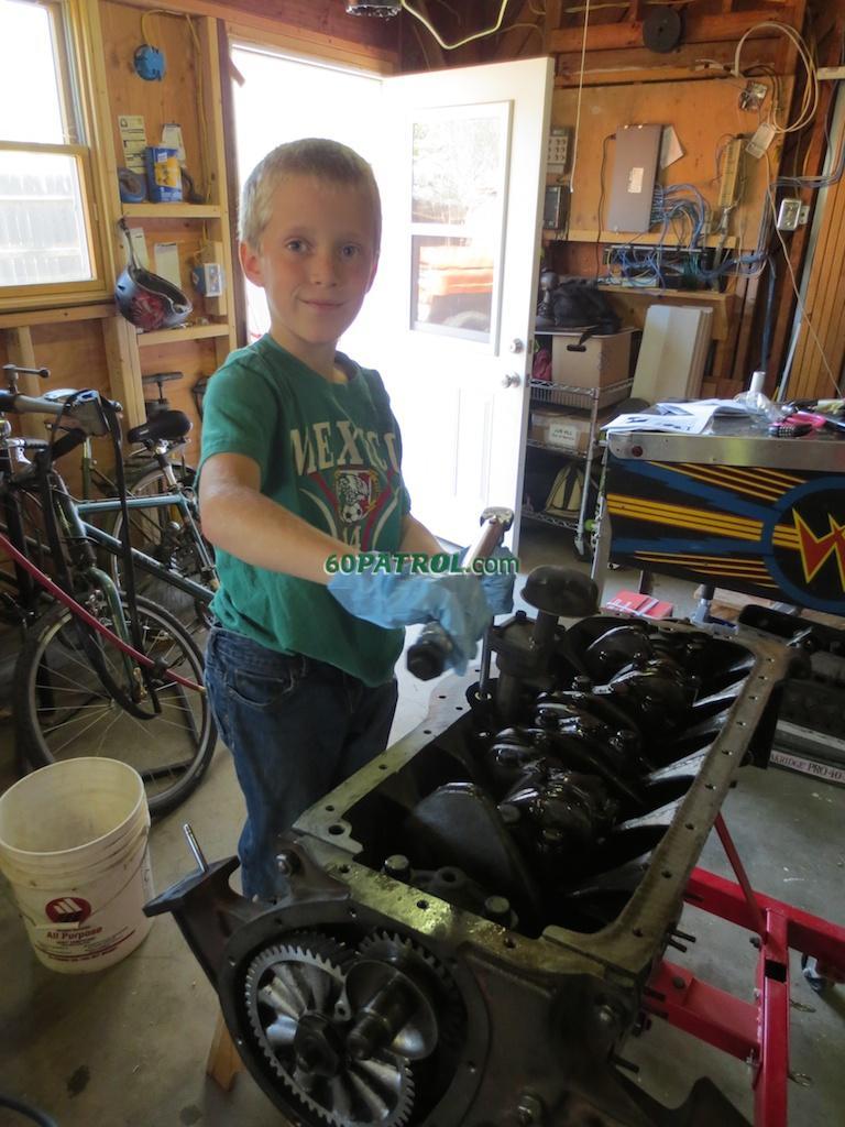

Jay and I spent an afternoon putting some of the goodies back onto the engine. Here's Jay installing the oil pump.
And Jay is torquing down the pump...
