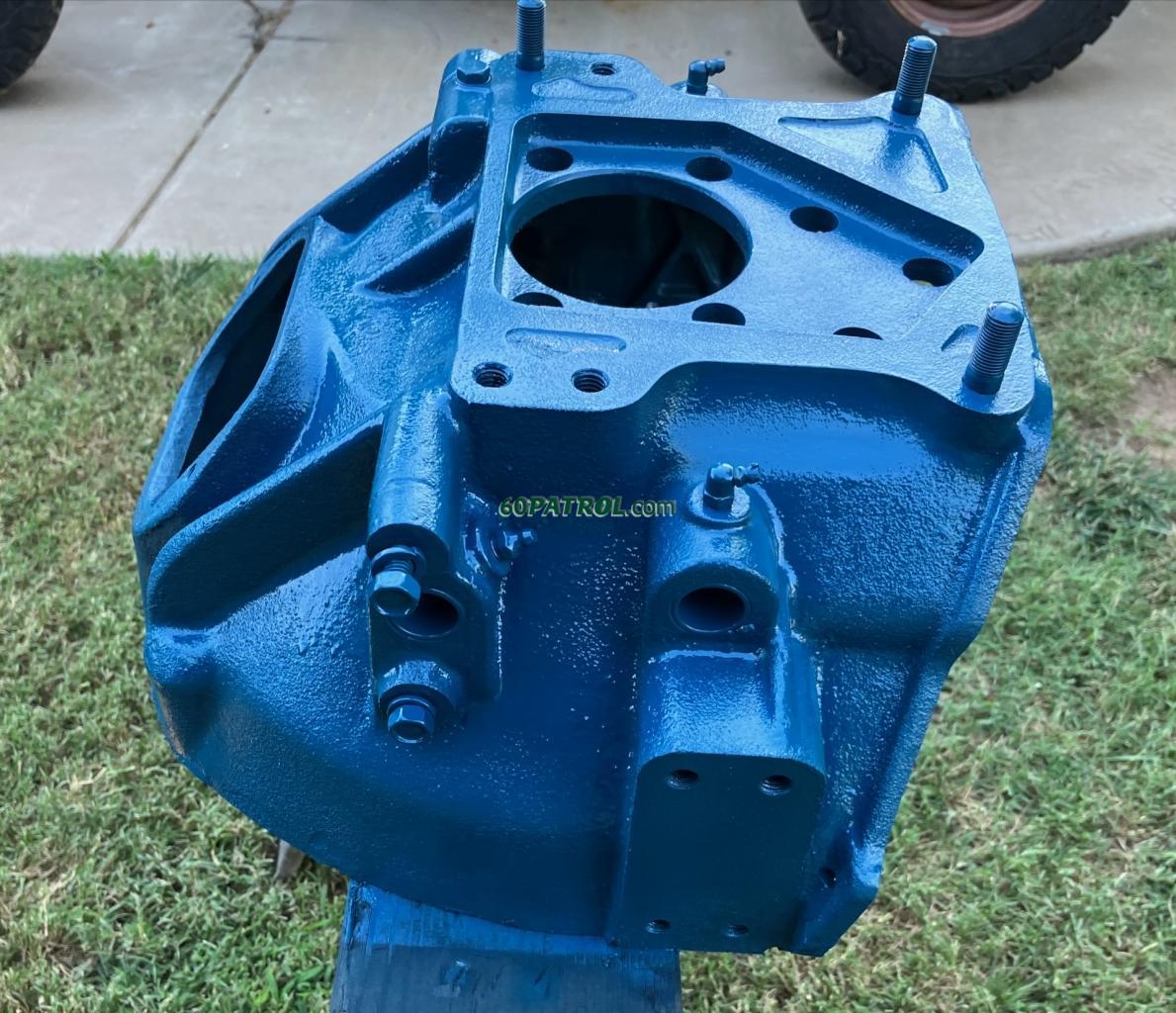

I pulled the bell housing out of the vinegar bath and gave it a pressure washdown
These two were taken at 2:57pm moments after the wash down was done. Looks great! Nearly all the rust and crust are a thing of the past!
As soon as I was done pressure washing, I gave the bell housing a wipedown with a towel, then set it in the hot California sun (97 degrees today) with a fan blowing on it to speed the dry off. I took this picture at 3:51pm -- just a mere 54 minutes later
Wow! What were we saying about flash rusting?
Next I gave it a quick acetone wipe down, then covered it with a rust-conversion primer (the same black stuff I used on the pan and valve cover... I just forgot to take a picture of it), then two coats of the blue engine paint. I didn't worry about bolt holes, mating surfaces or the brass bushings -- I'll clean those surfaces and replace those bushings later... I just don't want any avenues for rust!
Gettin' closer and closer... well, still a long way from drivable, but it's nice to see progress!
