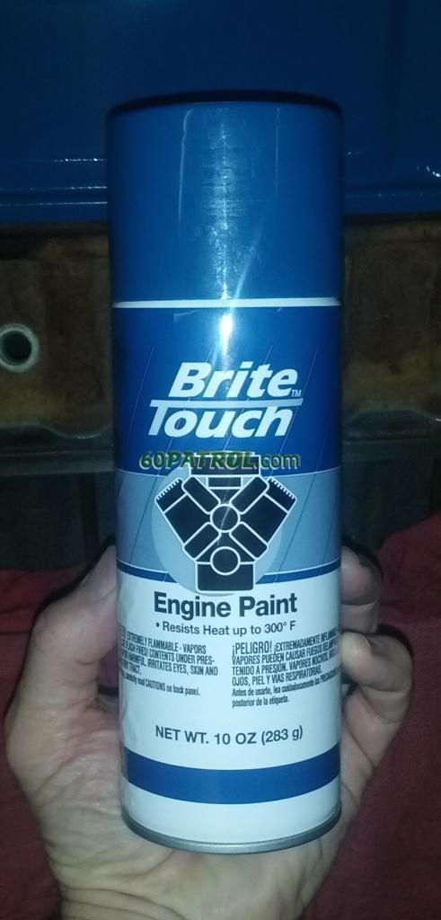

Okay, I'll fess up...
One of the valve covers has a little remaining splotch of original blue paint so the plan was to match to that -- My lovely wife, Emily, and I went paint color shopping. Of course, we left the valve cover at home. I was SURE that the Old Ford Blue paint exactly matched the valve cover; Emily was sure it was the GM Blue... Being keenly aware of the risks involved in the decision at hand, I chose to go with the GM Blue! ;-) When we got home it matched perfectly... See just how wise I am?
Anyway, here's the evidence (and notice how close the cap matches the paint):

Yeah, the GM corporate blue looked very close to me as well. I think either of the following rattle-can colors would work pretty well:
1) Old Ford Blue (Which was used on 65-older Ford V8's - not to be confused with generic Ford Blue, or new Ford blue, which are both too dark and too purple) - Old Ford Blue is just a shade lighter than the example of the Nissan blue I found on my 66's transfer case when I stripped off the light blue
2) GM Corporate Blue (used on engines in most 77-82 GM cars and trucks) LIke Faux40 says above-- this one is probably the closest "off the shelf" option to the Nissan blue
This one is also close, but not exact:
Chevrolet Blue (used on some chevrolet truck engines 55-61) LIke I stated above, it has a bit more gray to it, but the shade of blue is almost a dead ringer for the Nissan color

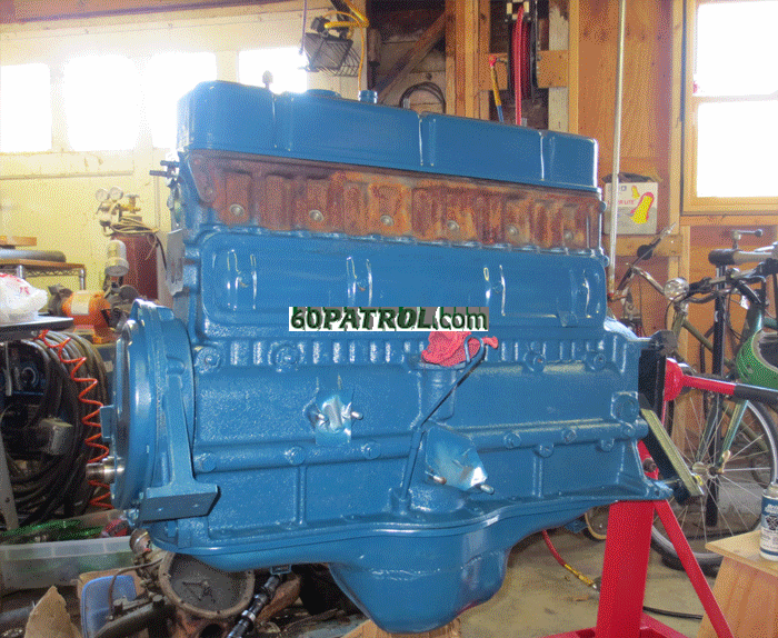

Even more progress! Lookie, lookie!
2499

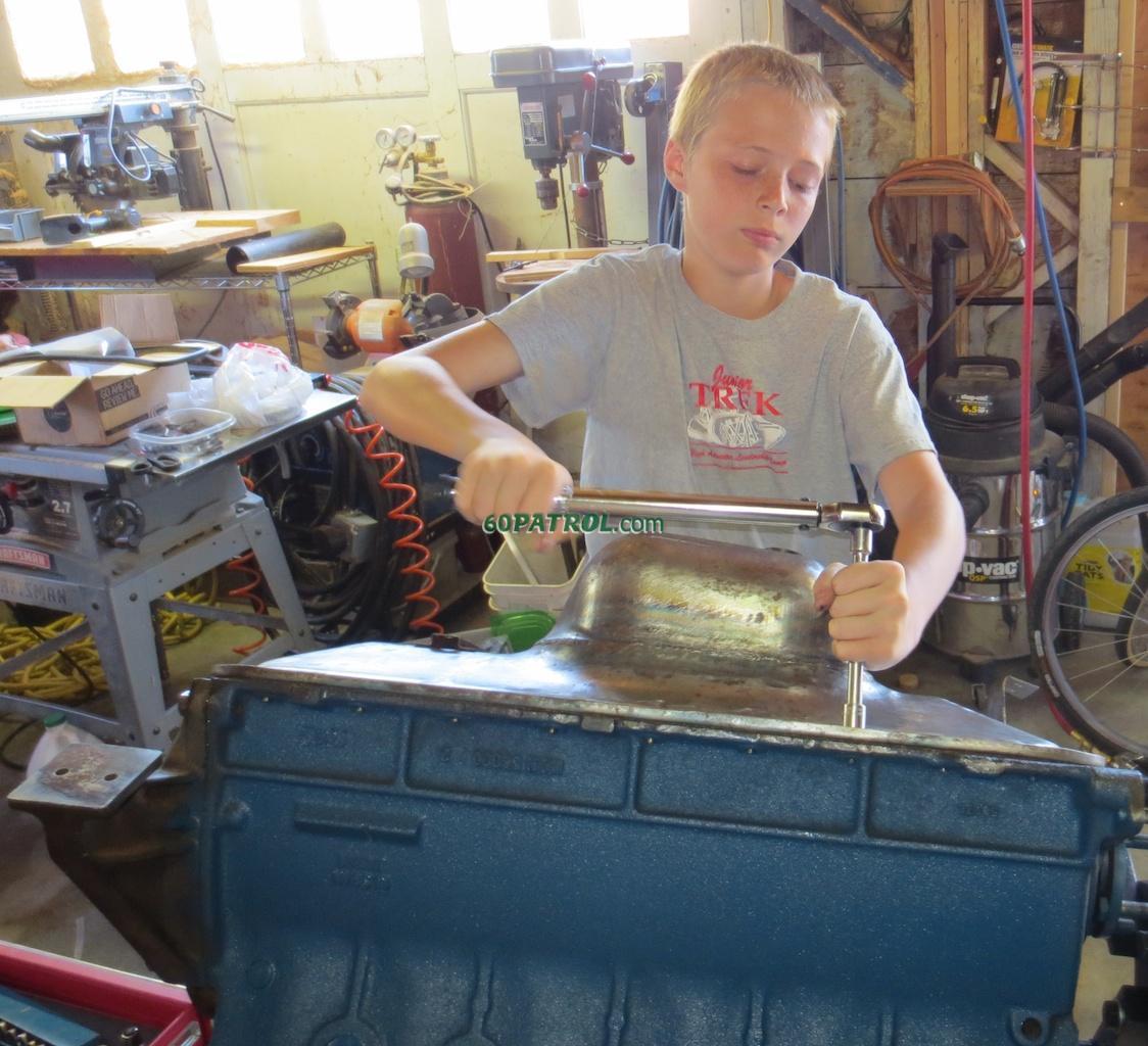

Anwyay, ended up getting grade 8 bolts for the pan and timing cover -- the difference in price wasn't too bad on such cute little bolts. Joe and I spent time time today bolting down the oil pan, installing the timing cover and side cover. That cover was a bit of a challenge as the gasket was a bit too small so we used some gasket adhesive to allow us to stretch and clamp it in place -- once it was really tacky, we installed it easily. Nice to see some obvious progress!
The side cover challenge - The adhesive worked like a charm!:
2494
Joe works on the pan:
2492
And here he properly torques the bolts:
2493
