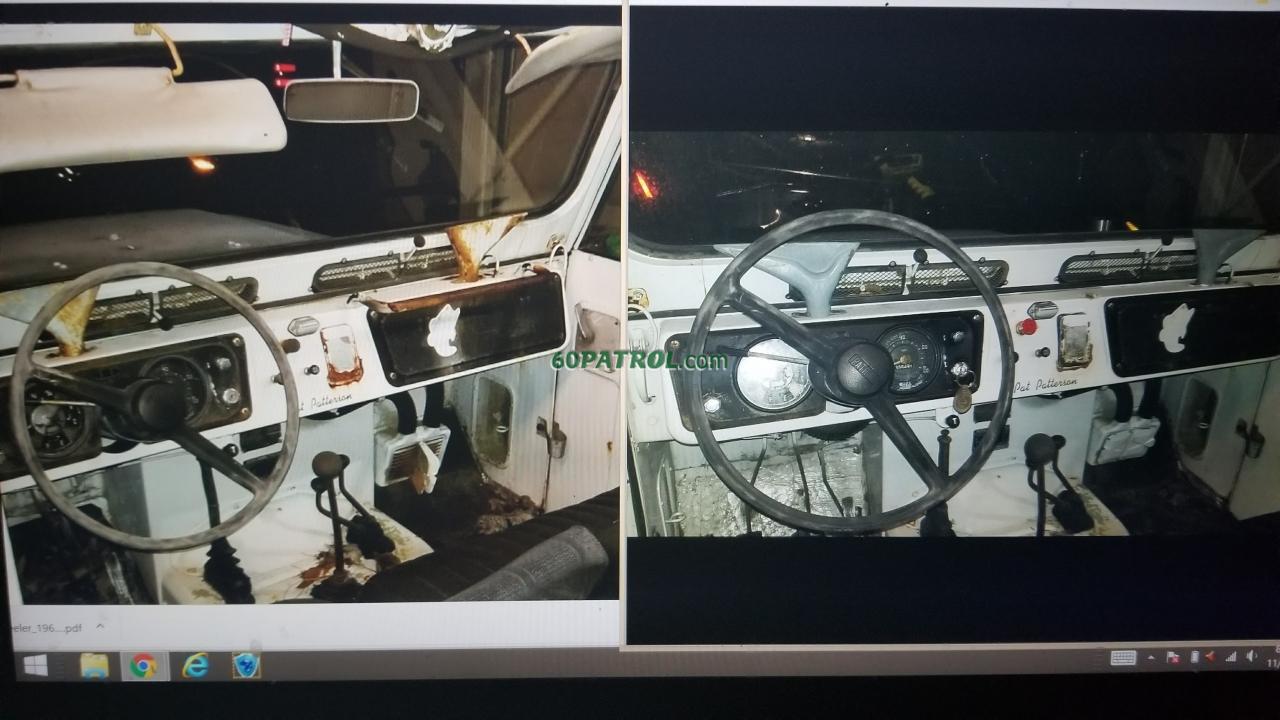

In the meantime, check out what a rust-remover bath and a wire brush did to the defrost vents and a few spots on the dash!
Happy Turkey Day!
Again, thanks to all of you for your advice. I will get back to tinkering when we return.
Happy Turkey Day!

Looks great so far! As Nizmut stated, the drums can be a bear to get off. I spent more time getting mine off than with any other item on the Patrol. Good luck!

Its a beauty,,,
congratulations, you will see you will fall in love with this sweet Patrol.
Can you share its story....
i seee theres a Pattersons name wrote on the dash board...
Just ask here whatever you need.
