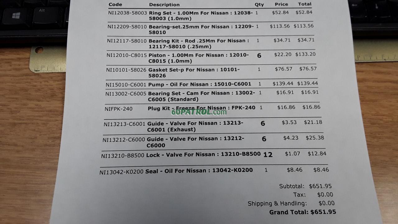

I found a source for the P40 engine rebuild parts (bearings, rings, cam, etc.) would those work for this motor? I assume they would but it would be nice to be sure
Thanks again for all the friendly help
Scott

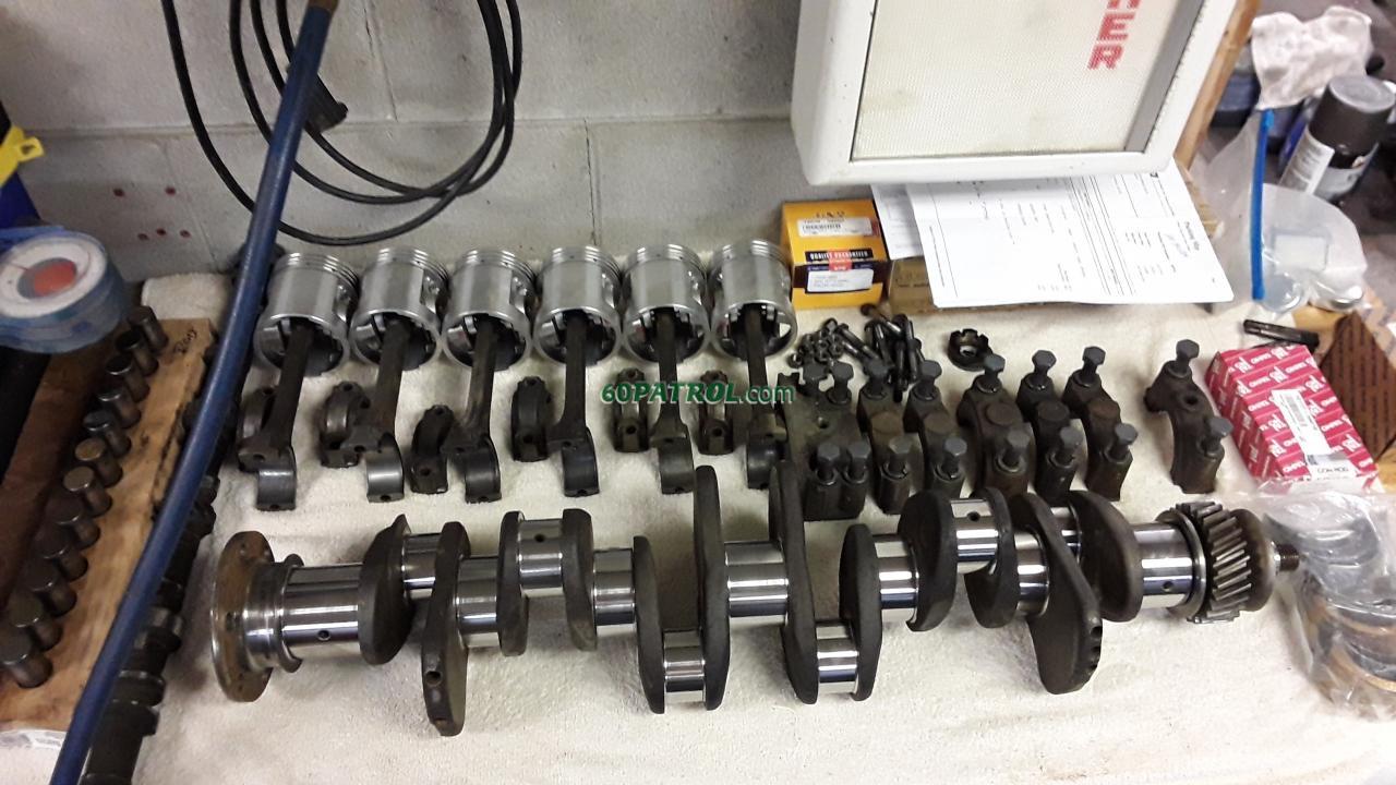

you will need PPU main bearings not P40... there are differences to concern with. I ordered all my parts from a forklift parts company. I have a bunch of notes of what parts I bought for my engine in the Projects area (1967 Patina). Or just use the search tab at the top and search for Forums about the engine kit. Parts came from Tiffin.

rdarnell wrote:you will need PPU main bearings not P40...
This is a very key piece of information.
Nissan put a lot of model P engines in Forklifts, but they referred to them as "PPU" So, whenever you are talking to a forklift supply company, reference the engine by the PPU designation, and oftentimes they will discover that they have a lot of parts, that they will tell you they don't have for the Model P engine... 8-)
but the key takeaway is that the PPU and the Model P are internally identical, part for part. The P40 is similar and some parts are interchangeable, but there are many parts for the P40 that are exclusive only to that engine. (Esteban is the Guru on knowing which P40 fits in the Model P/PPU, and which ones don't)
