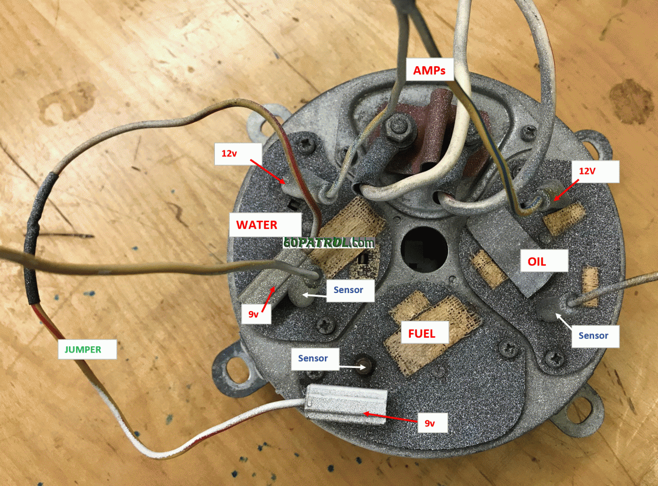

I'm working on the wiring again. Specifically the gauges and trying to incorporate the voltage regulator from amazon. In doing this, I had some questions/observations for the forum. In looking at the stock gauge, it looks like the voltage regulator may be incorporated into the water gauge. I have this spare gauge cluster that has original wires attached (see picture below). It looks like 12v come into the water gauge from the fuse block. There is a jumper from the water gauge to the fuel gauge that I think is supposed to be 9v. I put my voltmeter on it and it actually fluctuates between 9v and 4.5v. My question for the group is whether that fluctuation is normal, or should I just be seeing a steady 9v? I'm going to swap out the water temp gauges between the two clusters to see if that makes a difference. Good news is that when I hooked up the fuel gauge and the oil pressure gauge, they worked (I have really low oil pressure if the meter is working correctly).

The original regulator does produce the fluctuations in volts. Not sure about the Amazon replacement.

Thanks. The amazon replacement doesn't fluctuate- it is constant. Based on what you said, if I hooked back up through the water temp gauge, I think I would be fine too.

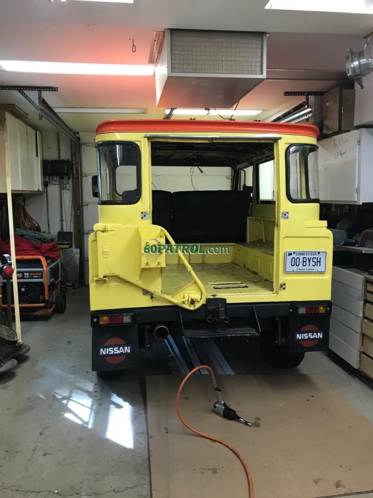

Today was the day for the Minion Missile to something it hasn't done since I'm guessing 1973... Take it's top off! Raul said that he and his crew can do it all in one piece. Since there's only a few of us and we have no interest in keeping the hardtop, we decided to do it in pieces. First were the rear doors, then the top, windshield and sides.

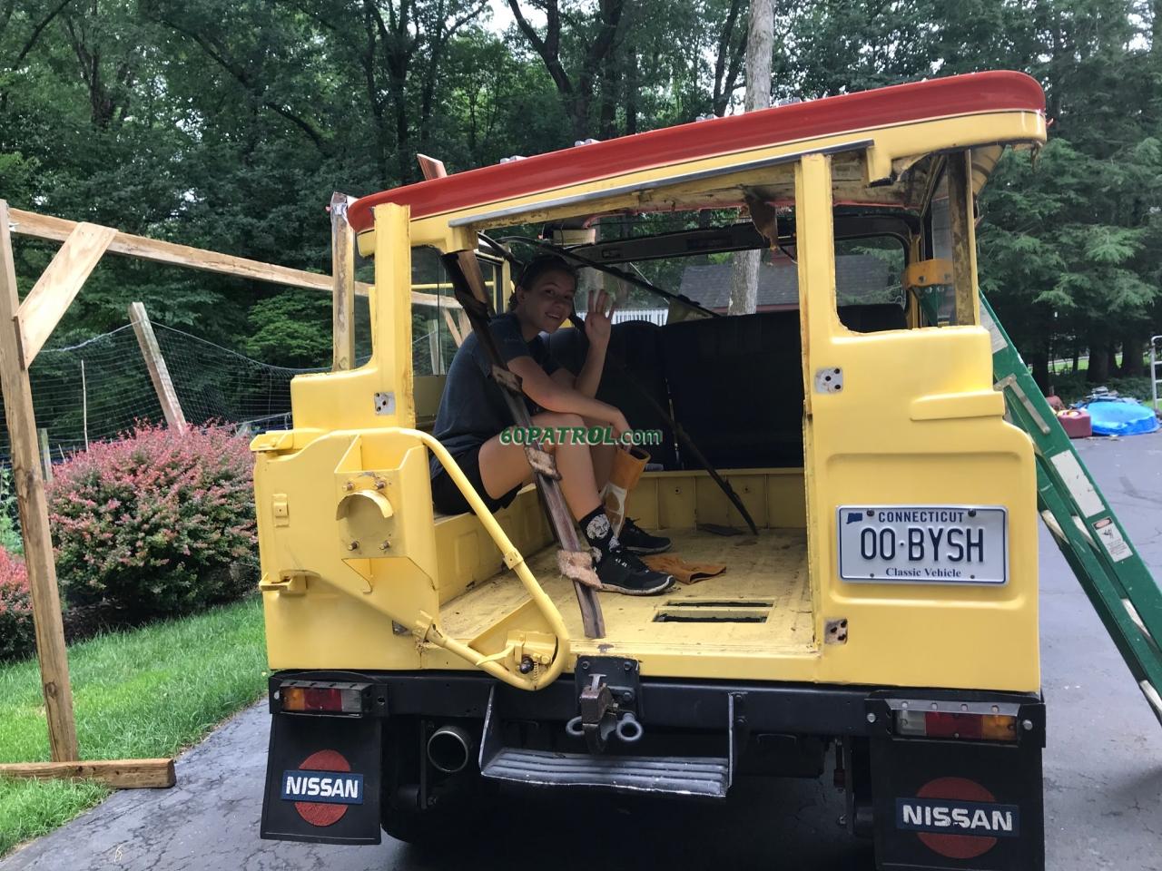

Once we freed up the top, Ann and I got underneath it and shoved it over the side:

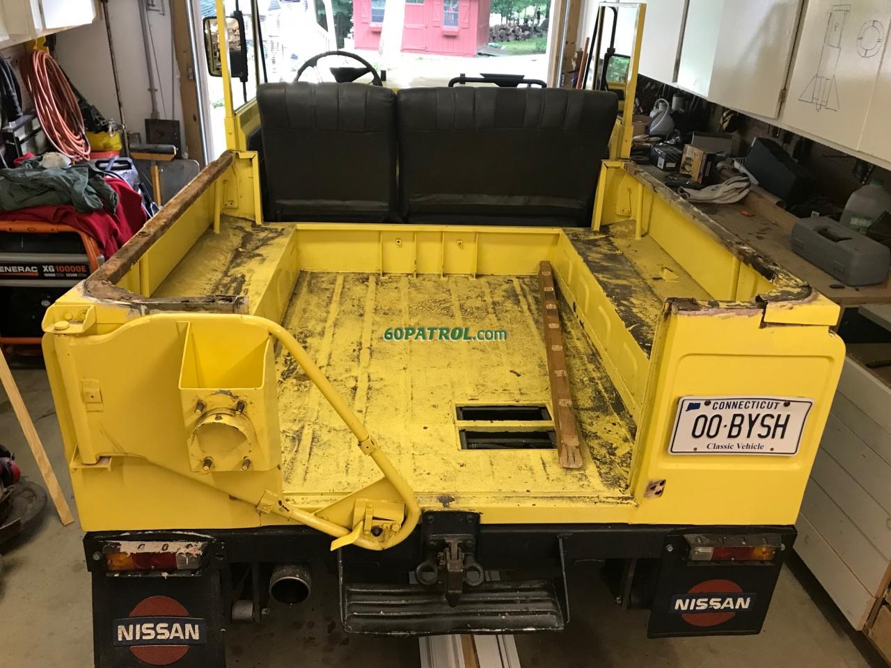

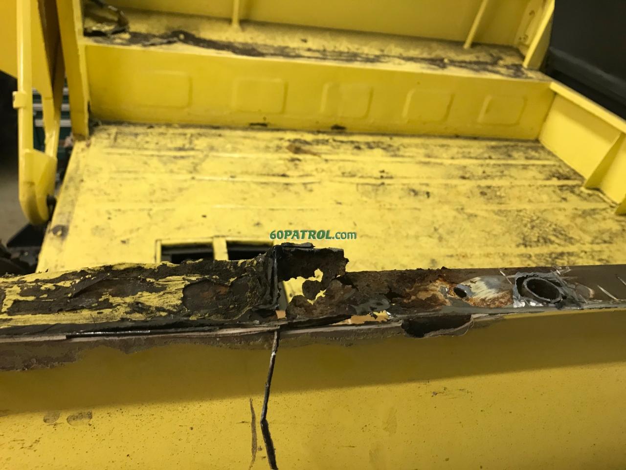

The hardest part by far were the sides. They were bolted down and then spot welded to the bed rails throughout. I was hoping that it was going to be pristine underneath and that I could get right to attaching the soft top frame I received from Raul. I wasn't that lucky. There's a fair amount of rust on those frame rails - a product of the top sitting on it and trapipng mositure for all of those years. I guess Ann and I are going to get more practice with that welder repairing some of these rust spots.

Good thinking about taking the top in pieces. Otherwise the frustration would have been bigger.
To bad about the rust condition of the top rail of the tub. I’ll guess that an easier approach will be to use a preformed member, maybe from som cold rolled profiles and weld them. I will keep looking for ideas.
