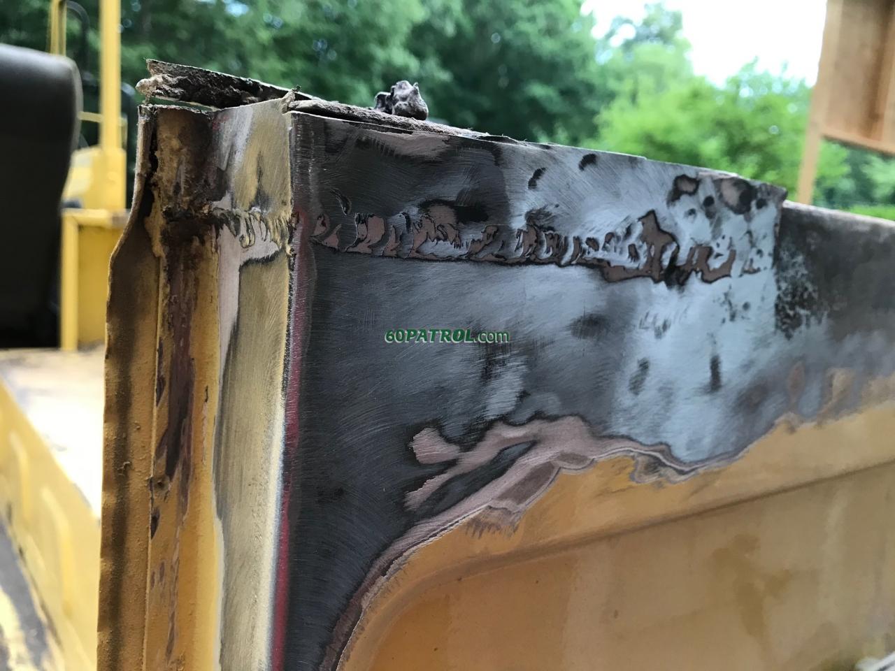

Hi guys,
so, working on this slowly. started pulling back the paint and surprise surprise found some more quality welding:
This craftsmanship was covered in a healthy layer of bondo. Wonder what other surprises this baby has in store for me?
Does anyone know what gauge steel the body is? I'm thinking 16 gauge, but maybe 18. The couple of panels in the back don't appear to be complex. Flat with 90 degree bends. I think I might be able to handle them with a little practice.
