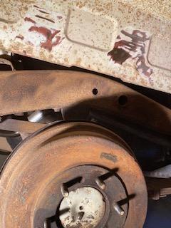

Well, that maybe what I will have to go with, as the vehicle already has four of them. As the wheels are off, what are the first steps in removing the brake drums?

The first step to removing the drums is to adjust the brake shoes, backing them off all the way. Then, a small pry bar - but don't pry against the backing plate, it will just bend - a big hammer or mallet, and some WD40 or other break free type lube. Hit outward on the outer edge of the drum, turn the wheel a little, hit and pry, turn the wheel a little hit and pry, repeat a bazillion times until the drum drops on your foot.The rears are a little easier because you can pry from the center of the drum over the axle shaft, fronts are not as easy.
