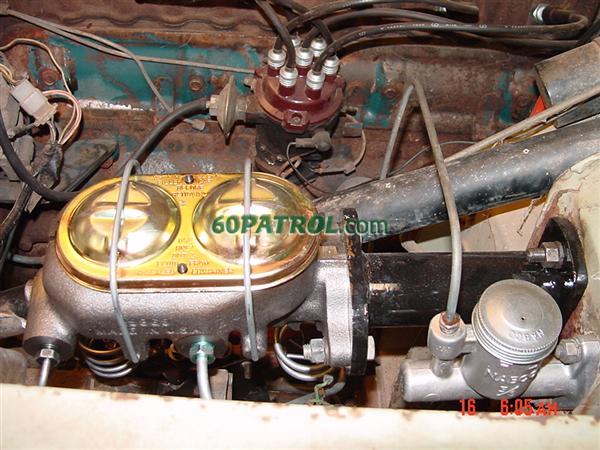

I also noted that you have the brake master cylinder of an american car, with an extension structure to mount it. Great. It will be easier when the time comes to put a booster in there.
You once mentioned that you have an overdrive in this Patrol. Pictures please!
Thanks for the kind words! I bought the distributor recently. It is the Helmar P40 compatible unit, their part no. 22100-C7000. The Pertronix 1761 Ignitor I bought 12 years ago, thinking I could fit it into the water protect distributor I had, but it no such luck. If I were buying it today, I would opt for the 91761 Ignitor II version which protects itself from a meltdown if the ignition is left on and the engine is not running and some better performance over a wider RPM range. I just followed Moore_rb's excellent directions in his how to for the pertronix ignition, and it started right up, first try.
The brake master is a 67' Corvette which works with the 4 wheel disc brakes I converted using Chevy truck calipers in the front and Cadillac Seville/Eldorado in the rear. Chevy Truck Rotors (fronts were 3/4 ton 4WD-fronts and rears were 1/2 ton 4wd front rotors) and farm engineered mounts. Here are some old pics from the gallery under npca-rickg.
