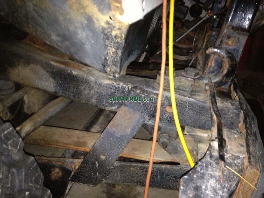

I think new springs is the only way to go. I haven't looked at the questionaire yet but if I can sell off a few other "projects" then perhaps I can gather some more parts. The plow setup I'm manufacturing is the real reason that lead me to look at springs. I want to make sure that the mount is appropriate for the height and so on although I did come up with an idea for adjustment.
Going to borrow a plasma cutter withing a week or so and start pulling things off. While the current plow mount is beefy...it's really awkward and limits access to things.
That plow mount looks just like the one that was on a Patrol I got out of CT. And you're right - it really limits access to everything. Togo's plow mount was a little different, maybe because it was hydraulically operated.
The original hydraulics were pulled although I wish I would have kept them. The meyer setup was from Mystery Patrol.
The person that did the installation for the mount was arc welder happy...it's going to take some work to get it off clean. Especially trying to save the bumper. I'm going with my own design for the bumper but I know it would be worth saving as long as it's feasible.
Leaning towards the Alcan springs if I can swing it. If not, I'll run the existing springs a while longer.
The plow mount on the CT Patrol was welded on also. I don't remember where it was welded, just that it was real difficult getting to the bumper bolts. Good luck with that process. Angle grinders work well for cutting welds.
