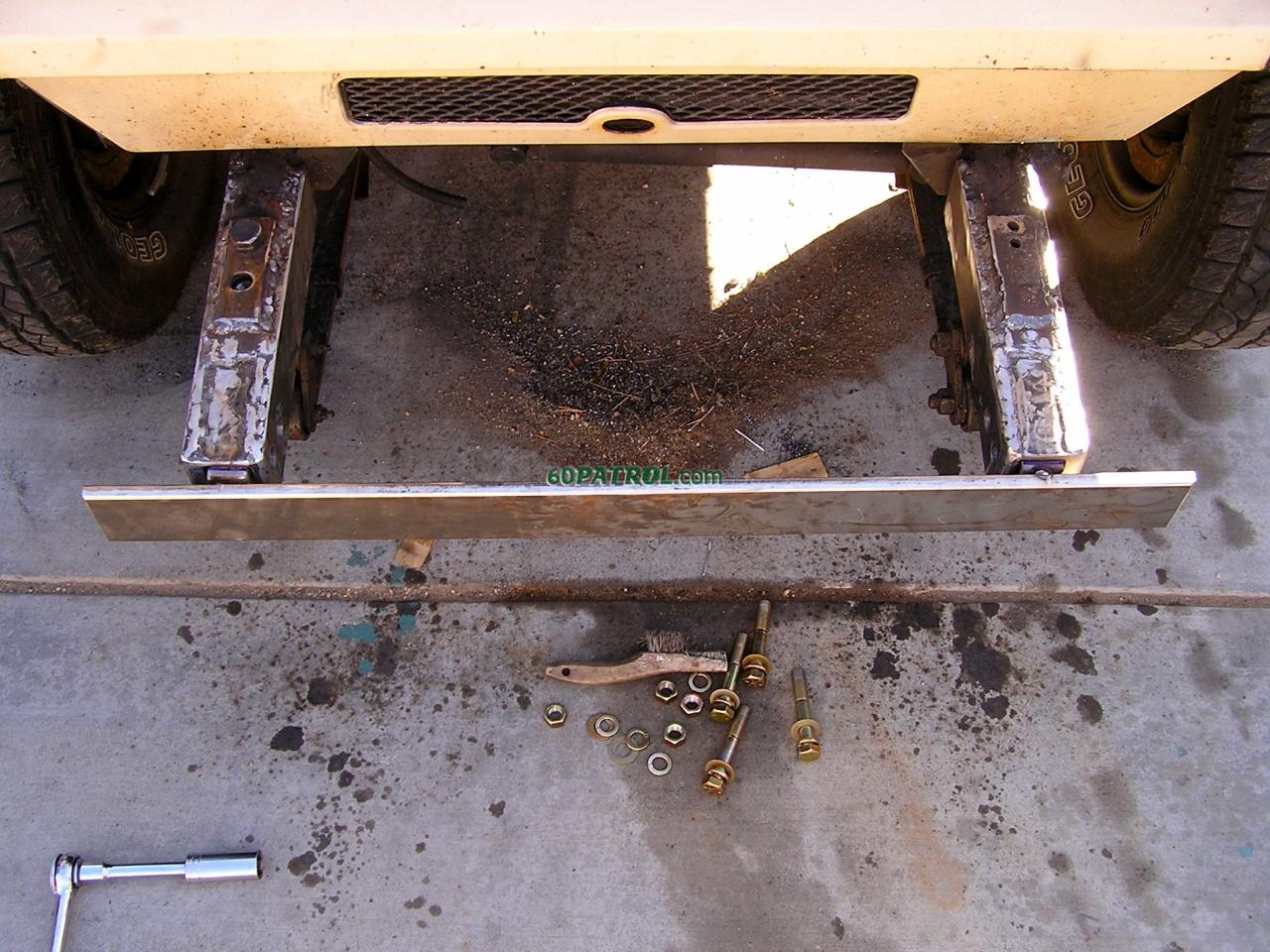

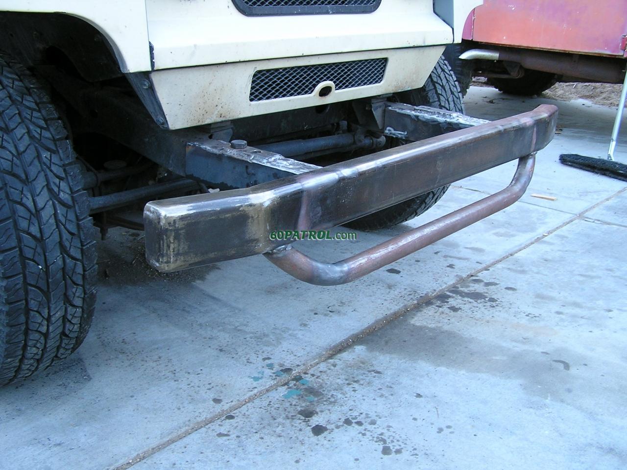

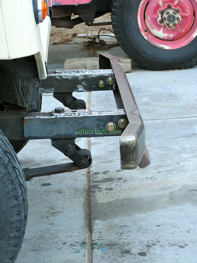

I was able to practice on the other stuff due to the relatively low cost of materials before offering to sell.....with confidence. This will be the bumper bullbar I have wanted to make since getting a Patrol....I hope. The job that Rawmi has done is great and is similar to what I see but I will stick to a combo of what is affordable and obtainable for me, what I can technically make with the tools I have, but never cave in to some stupid looking "shopping cart pusher" DIYfest.

Looking good but why the lower tube section? Seems it creates a loss on approach angle.

It does. The extension does not help that either. I really will take the small loss for the situation that my area has.
The gain is that most of the driving is on loose rocky roads where they stick up and clobber the springs. I drive these sections slow and many times have to get out and move stuff/rocks too big to go over. This will be my "feeler" bar....subject to change if smashed.

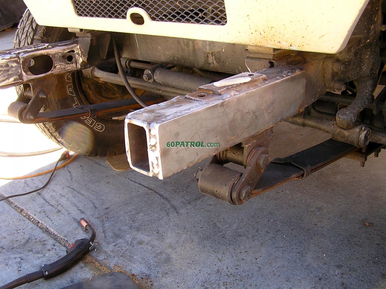

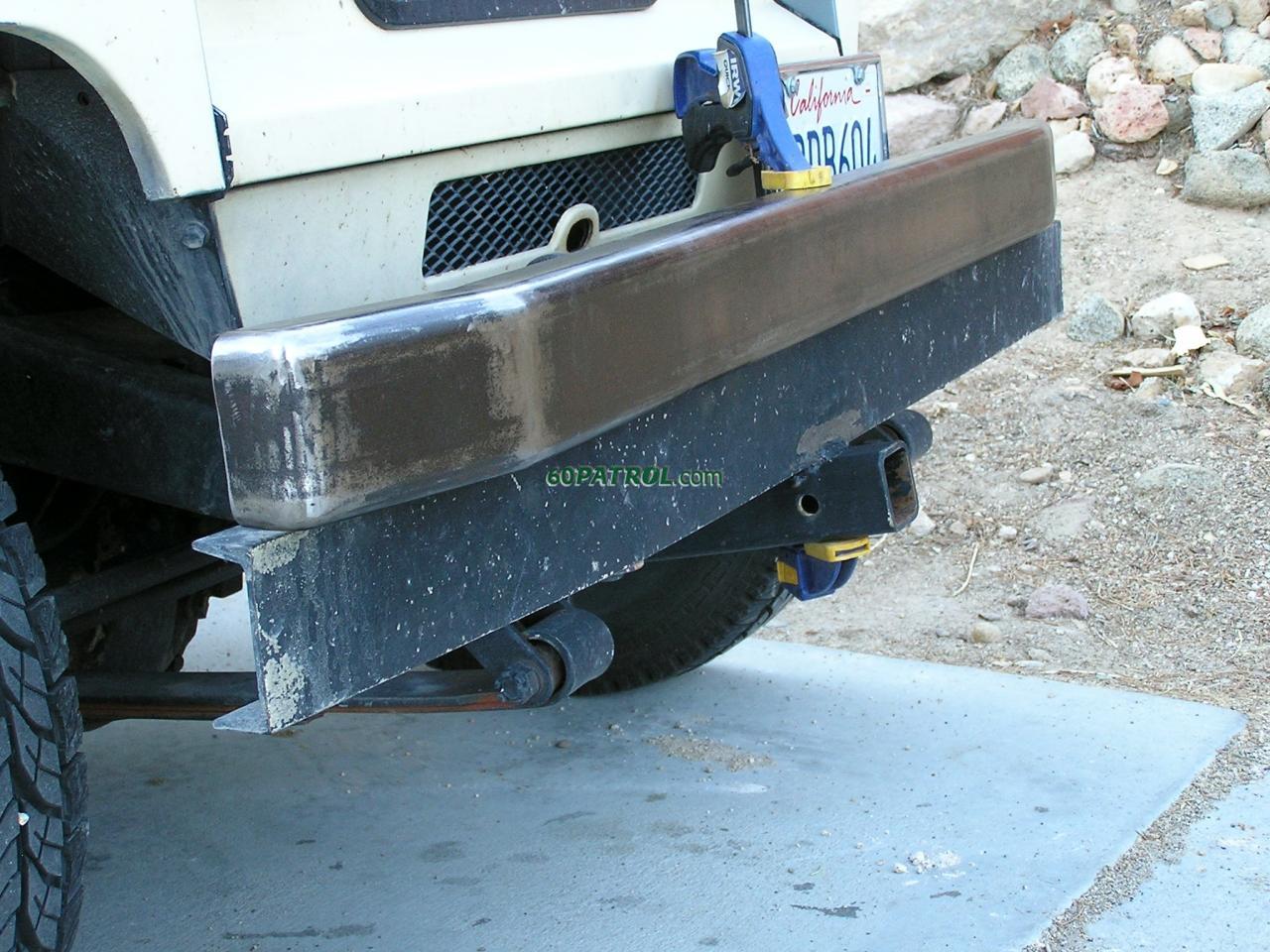

I should say that it is not finished and I did show pics of things in stages so hang on. Welded between the bottom bumper and the bar will be a 2" receiver. I will bolt the back of the receiver to a 2 x 3 cross member welded in place. All this is for a trailing set up I have that uses a receiver.
