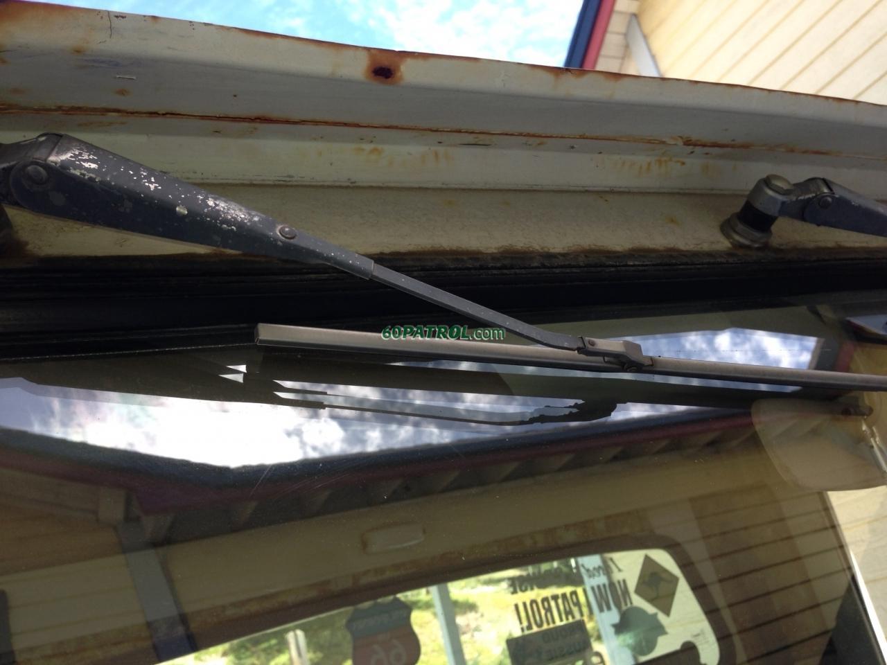

- I love driving my Patrol!
- Posts: 1203
- Joined: Fri May 10, 2013 5:35 pm
- Location: Winslow
- Has thanked: 652 times
- Been thanked: 632 times
- Contact:
Re: Wiper blade inserts for '69 and later Patrols
I have these on my 66.Esteban wrote:I've been using this type of wiper blade without a problem. Carquest 11-51
The bayonet size is 5mm (~7/32") It's a very tight fit but it works! I've also used some other brands.
Please note that I changed the wiper system on my 65 to the ones the came from the now gone 74.
I'm going to find my old wiper arms from my 65, since in those ones I took apart the insert at the tip of the arm, and was able to use regular wipers.

- Administrator
- Posts: 7814
- Location: Temecula, CA
- Has thanked: 7688 times
- Been thanked: 2476 times
- Contact:
That actually looks like the pre-69 blade. Might be a good replacement for them.
