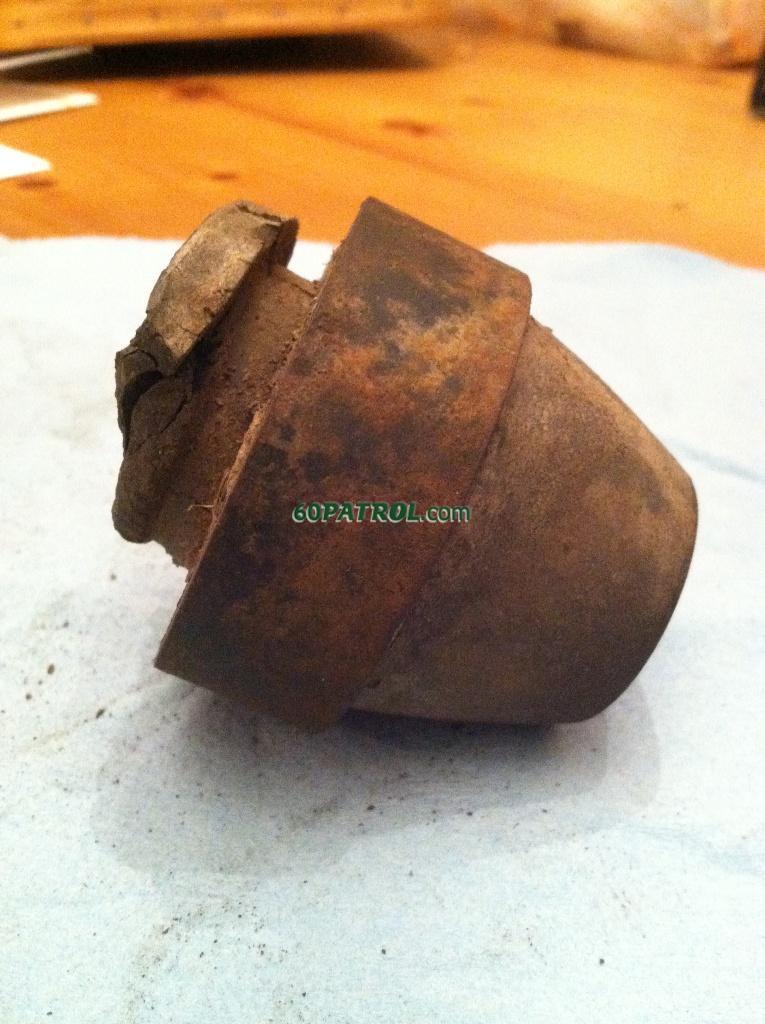

I need a Rebound Stopper for the front axle if anyone has one out there that they are willing to part with, as mine is torn around the bottom where the lip is. Any help is appreciated. Thanks in advance.

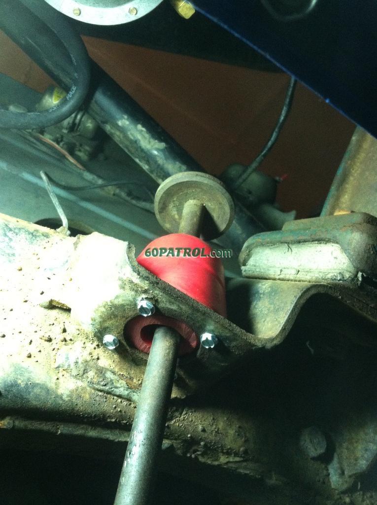

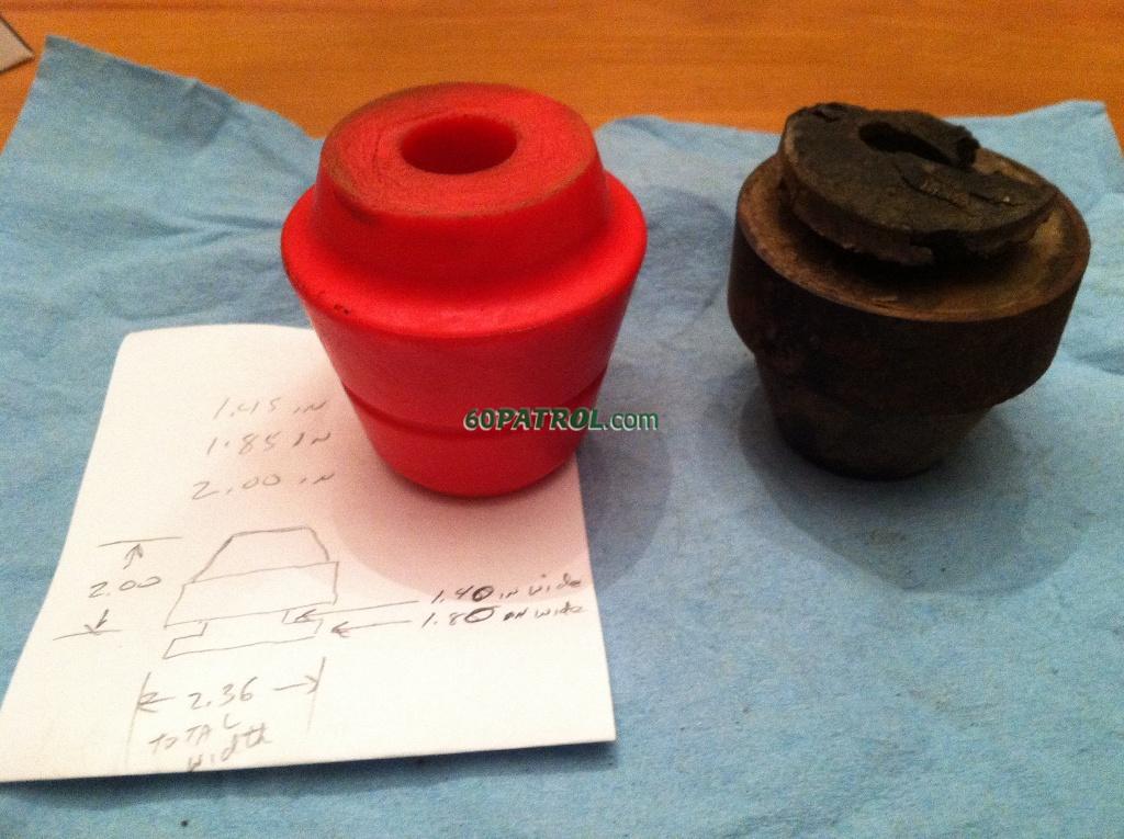

I have a solution for you on this...
Energy suspension p/n 2.9101
376837673766

Nice find! That looks like a perfect replacement. :handgestures-thumbupleft:
