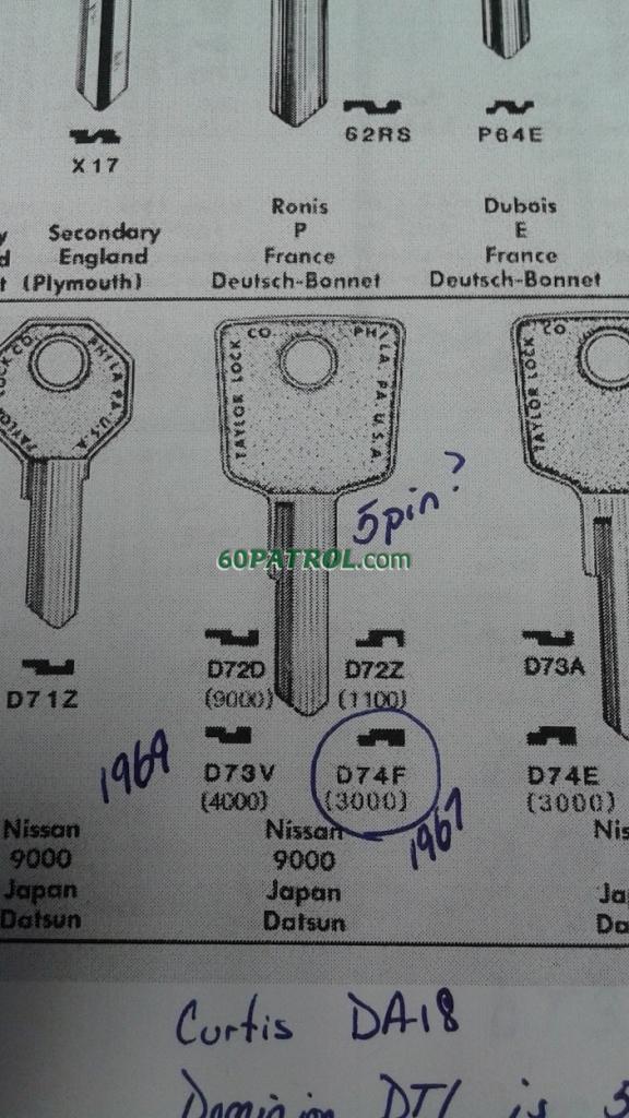

I have been searching for the correct keys for the Patrols. I have what I think is the original key for the 1969 Patrol but my 1967 did not have an ignition switch. I did find a key in the back but I think it might be for a Datsun car or pickup, it is also an octogon head with NISSAN MOTOR CO on it. the manuals post on here seem to show a tear drop shaped key?
I have found a couple charts that show the keys. The key for the 1969 and 1967 are similar but the profile of the key way is reversed.
The key the patrol uses looks to be a 5 pin but the 6 pin can be used and cut off.
For the 1969 I think the key should be an Taylor D73V which should translate to Dominion DT5, ILCO DT5, Orion DA15, Silca DAT2, I have not found a Curtis number
For the 1967 I have found a key marked by Curtis as DA-18 but it is a 6 pin key, the 5 pin key is possibly DA-14. It should be the Taylor D74F, Dominion DT1, ILCO DT1, Silca DAT2R, Orion DA15L.
Key blanks for these numbers do not seem to be plentiful in the Kentucky area.
