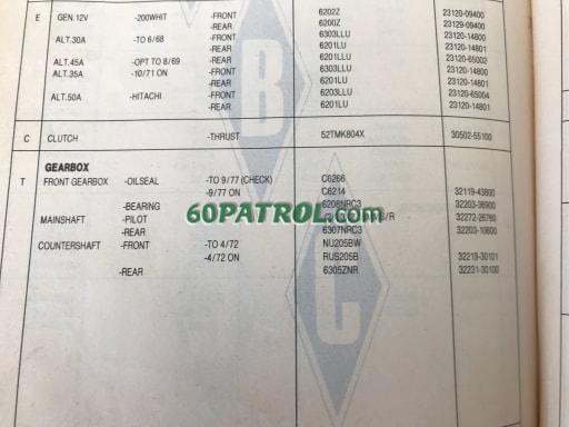

G'day all, Got a Couple of Gearbox Overhauls going on at the moment, but finding it Difficult to Determine exactly what front Layshaft/ Counter Shaft Bearings I Need.
Both are from 1970's Patrols, One has the Early Style Lay/Counter shaft With the Replaceable inner Ring that presses onto the shaft for the bearing to Run on, Far more Superior Design then the Later 70's one's which I'm also doing up that has no Inner Ring where the bearing runs Directly on the shaft.
Been To A couple of local Bearing Suppliers, and got a Rebuild Kit to suit the later Box (Which I planned to Do and had apart before This one with the Earlier Layshaft, but LONG Story Short Been Slogging it out getting a G60 Ready to Register and have it ready to take away on a trip Next Year, This is the Car With the Early shaft In it, and I need to get it back together as I have a Deadline to meet, the Red Tub Ute with the later Shaft doesn't need to meet a deadline for Rego, so its now next in line.
I will be using all the Brand New bearings I Ordered for the First Gearbox I planned to do up, I just need to work out what is the right Bearing for the front Layshaft for the earlier Style.
They have Books and a Database on the Computer for complete bearing Kits depends on year model, the only change in bearings is this Front Layshaft One.
There Listing are Up to 4/1972 a NU205BW
From 5/1972 a RUS205BW
Now Both types of old Bearings in these 2 Box's only have 205B On them, Not much Help :roll:
Both Shops That I have Tried Locally, have the same Bearing Numbers Listed as per the change over dates, Done heaps of Googling and Cannot Seem to Find Brand New NU205BW, or RUS205BW bearings. The Kit I Originally Purchased for the First Gearbox I attempeted, the New Bearing has Both the NU205Bw aswell as RUS205BW stamped on the label as you can see below , It doesn't have an inner race in the packet, and I haven't tried this against a later shaft shaft, or a shaft with an inner ring on it, just odd it is stamped with both Numbers :think:

Below is the Bearing Suppliers listings for the bearings
6577
Im just trying to work out this issue, I cannot find new bearing as per the exact numbers form the bearing shops listings, I need to know what types I need so I can make sure ill have the right bearings for both these Box's.
Would be very much appreciated if anyone else has faced this issue! Look forward to hearing any thoughts, cheers G60 Michael

MIchael,
You've done a fantastic research on this specific bearing, and I don't think anything else can be added.
Having had the two versions of the transmission at some point, my 65 and a 74 that I totaled, I concur with you that the older design for the counter shaft with the replaceable inner race is a much better and long lasting design. From what I can recall from years ago, Nissan will have just one part that covered both designs, and depending of the year you'll be using the inner race or not.
A member here used a regular bearing, 6205J for the older design (before 1972). However somebody pointed out that it will difficult the assembly. Measurements match.
