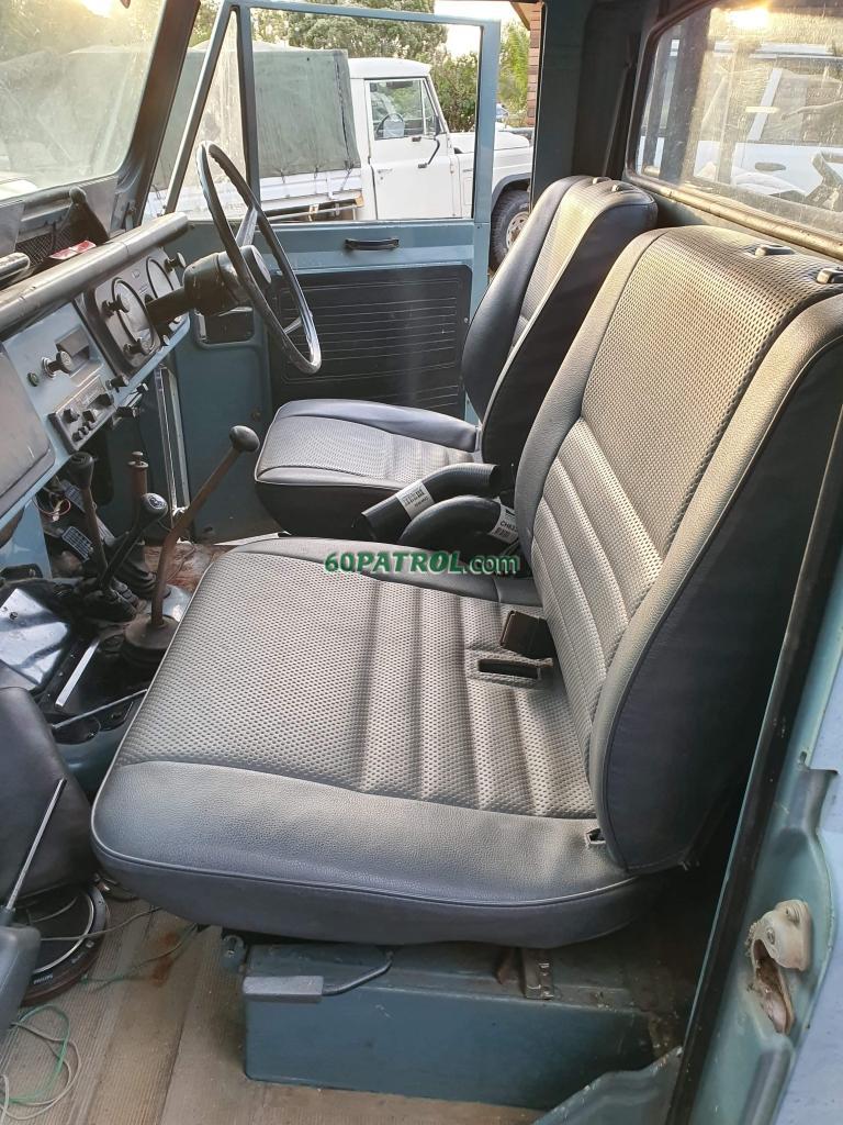

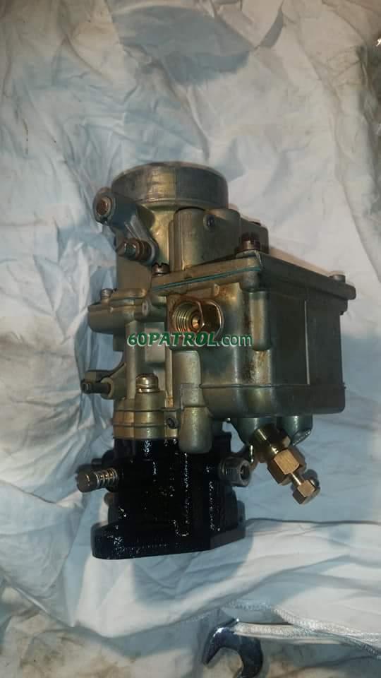

Have managed to so far clean up and rebuild a stromberg carburetor and oil bath air cleaner 6808 rebuilt the dizzy and alternator 6806 radiator has been professionally cleaned, rear wheel bearings replaced and wheel cylinders been rebuilt- luckily for me someone has already gone to the trouble of stainless sleeving them! :dance: 6728 6771 new shock absorbers installed, i didn't have any original seats for it so chose to install some 79 series landcruiser seats that i had laying around 6805 Also got the clutch hydraulic lines remade and all installed and air bled out of the system.
hopefully i attached the pictures correctly, stay tuned as theres more to come yet! cheers

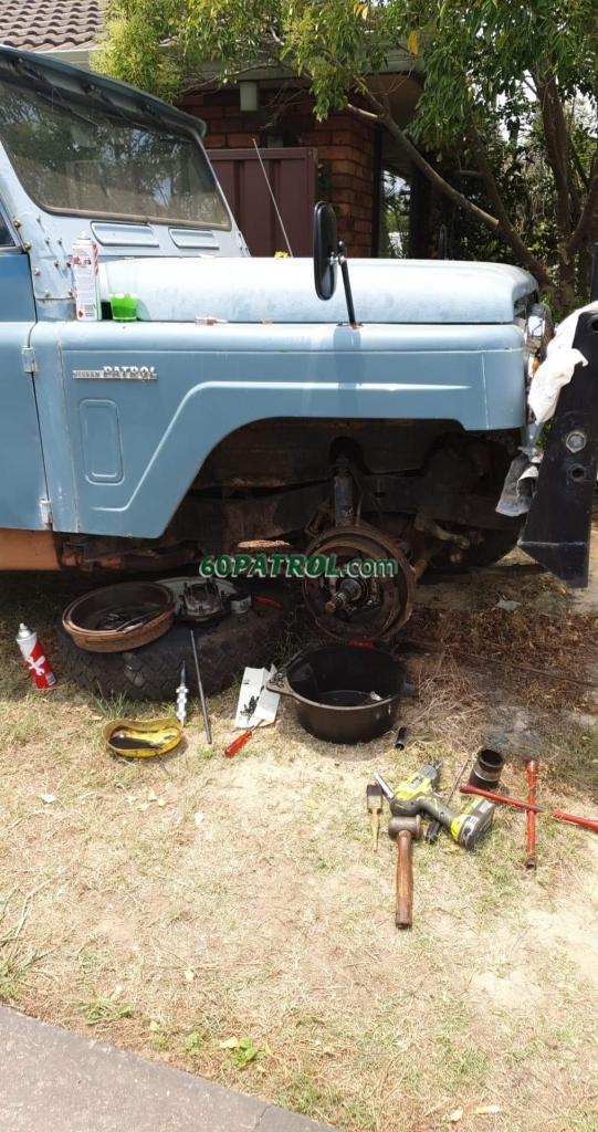

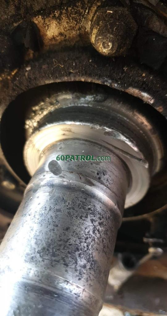

The past week or so has been very busy! Now all wheel bearings have been changed, and all the brakes have been replaced or rebuilt, but as always not without drama! Upon removing the front hub i noticed a piece of steel shim stuck in the grease between the 2 wheel bearings! Closer inspection revealed that both bearings had an issue some time in the past and the larger inner bearing had to be cut off with an angle grinder, you can see the marks on the stub axle.
6820
I tried the fit of the new bearing on the stub and it was worn badly and flopping around, so obviously someone has tried to use the shim and pack out the worn part to bearing ID, so then off on a half hour drive to where i have access to a parts car and got another stub.
Next day and back at it, at this stage i really wished i picked up the hub from the parts car aswel, because the original hub had been damaged and been machined inside with a spacer inserted, a good job had been done on repairing the hub but for me its just 1 of those things that will be on the back of my mind when driving out in the middle of no where, then finally putting the free wheeling hub back on 1 of the studs stripped the thread! :( great! More to fix

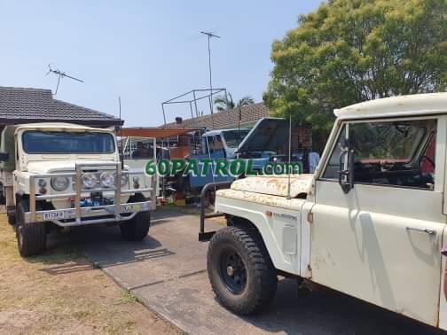

Its always good when working away most of the day and someone stops in for a chat (especially when they drive their g60!) and to see what progress has been made, a beer and some encouragement is sometimes needed.

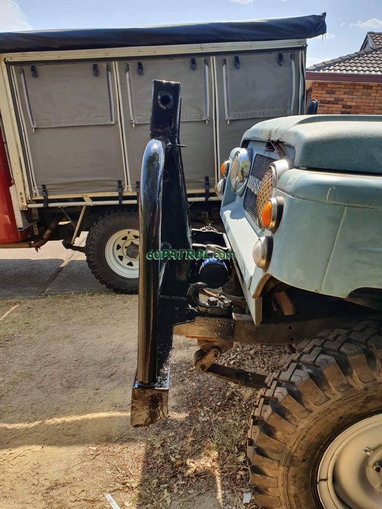

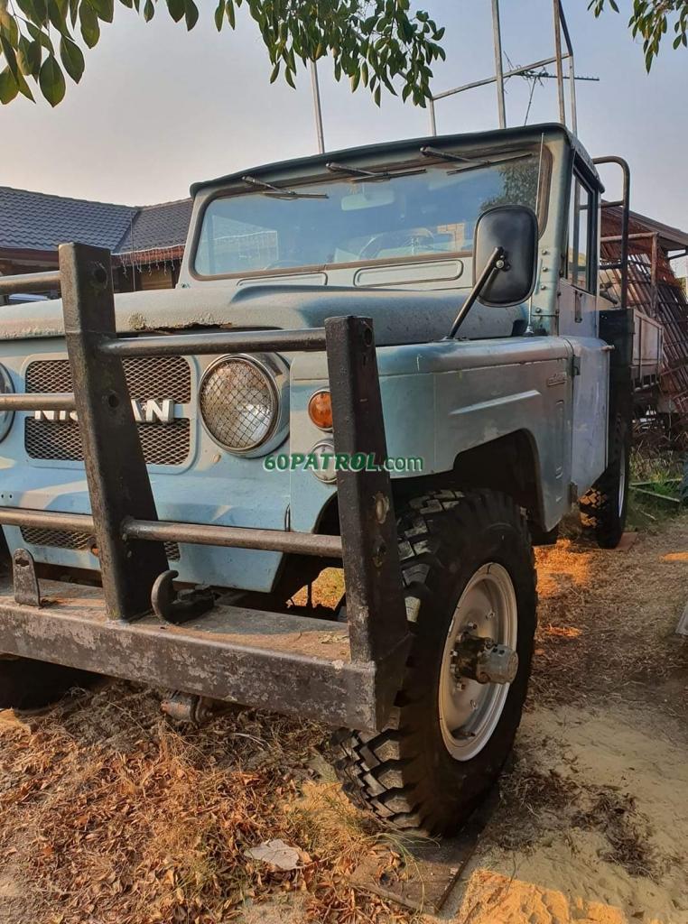

So now that all the brakes had been adjusted and wheel bearings done i thought what better time than to tackle the bullbar, the upright parts on the ends seemed to be blocking the indicators and just looked too bulky, i wanted to fit a winch so the bar had to also move forward and new mounting points fabricated. This is the end result, i think it turned out pretty well, just need to fit the rollers for the cable, fit the uhf aerial and spot lights.
6816
6817
