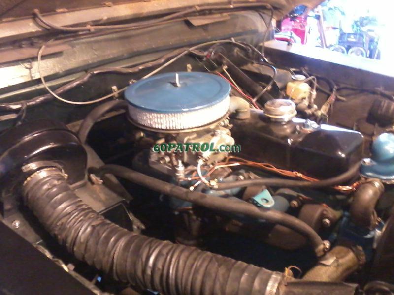

Mounted with bowl facing forward to allow throttle linkage hook up. The bowl has an off road kit installed (longer vent plastic insert to prevent fuel spilling into the throat of the carb... )
