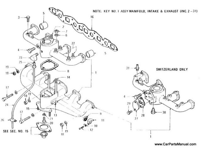

Since you'll be installing headers, the gasket is a non issue. But if for the moment you'll install the original exhaust manifold, then this gasket needs replacement.
The gasket I'm referring is between the two manifolds, #8 in the following diagram:
The exhaust manifold is open at the top and has a baffle connected to #13. This baffle moves by means of a bi-metallic spring fitted to #13 and allows the exhaust gases to heat the base of the carburetor in cold weather.
Don't worry too much not having it. In mine the baffle is welded shut in the hot weather position since my bi-metallic spring broke decades ago. Never missed it.
